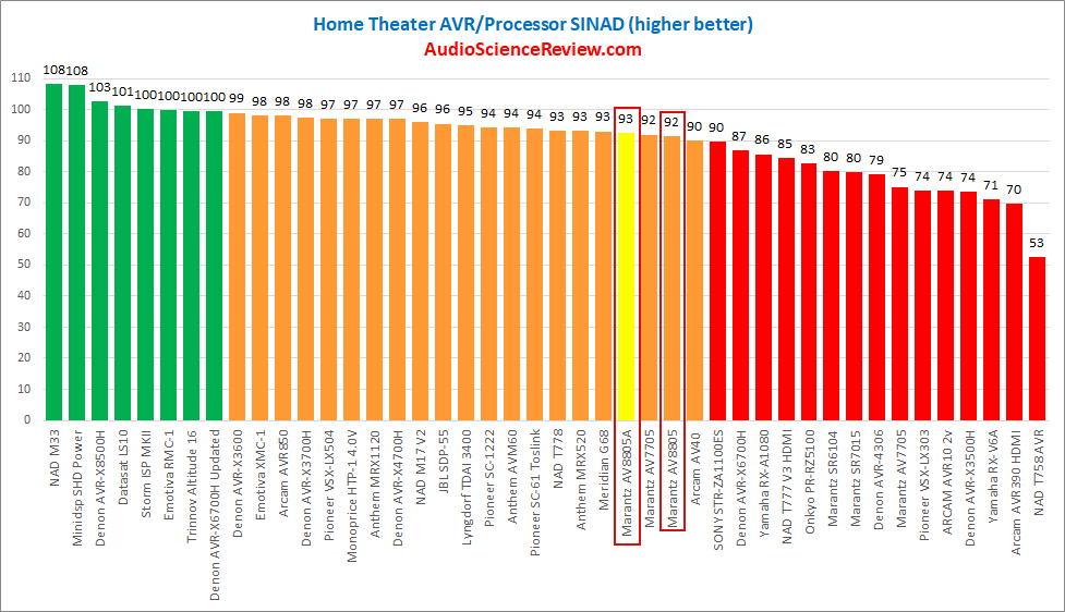

As ADTG said, it is highly doubtful that there are anything in the $4,000+$5,000 pre/pro that has differential connections from input to output. The only one that qualify to claim such topology is the now outdated Denon AVP, regardless of price, well, the $23,000 Datasat RS20i does claim "fully balance" but does that mean fully balance from input to output? Or just the DAC section, we don't know that for sure.
Even at the $23,000 price point, there is no 8K/HDMI2.1 support, ouch!
If you only need 11 to 13 channels, and must have XLR connections then I would just pick one from ASR's reviewed/measured list because then you can read about their "bugs", "fixes" and measurements.
The RMC-1 and the HTP-1 both measured good enough to be in the top 20 on the chart so you can just choose based on features, look, prices and perceived reliability.

I mentioned this in other threads. I find it interesting that most of my clients who are looking at the $5000 AV8805A vs $4500 X8500HA (similar enough price ) are buying the X8500HA mainly because of the measurements from Amir, not because of the small difference in price. :D
Back a few years ago when many publications were still doing measurements (S&V, Stereophile, etc.), I would have NEVER seen anyone choosing an AVR over a pre-pro when both were similar in price range. :D

Right! I would also add that if someone has read enough bench test measurements from S&V, AH, HTHF, and now ASR (Amir) for AV preamp processors that have both balanced and unbalanced measured, they would even be more inclined to consider the X8500HA, MRX-1140, possible the newest Yamaha A8A and just use them as prepro. Yes, it looks like a waste of the internal amps of a flagship class AVR, but it is also nice to know all or any of the internal amps will be there if needed for any reason, and it is also nice to be able to take advantage of the typical deep discounts on the last year models when the new ones are out.
Tests after tests have shown clearly XLR offered no better results in THD+N when the interconnects are kept short, such as < 2 or even 3 meters. There only nice things about them are the "click" if neutrik connectors re used, and if used with power amps that offer the same gain to both XLR and RCA input, such as the new gen ATI amps and a few others.
