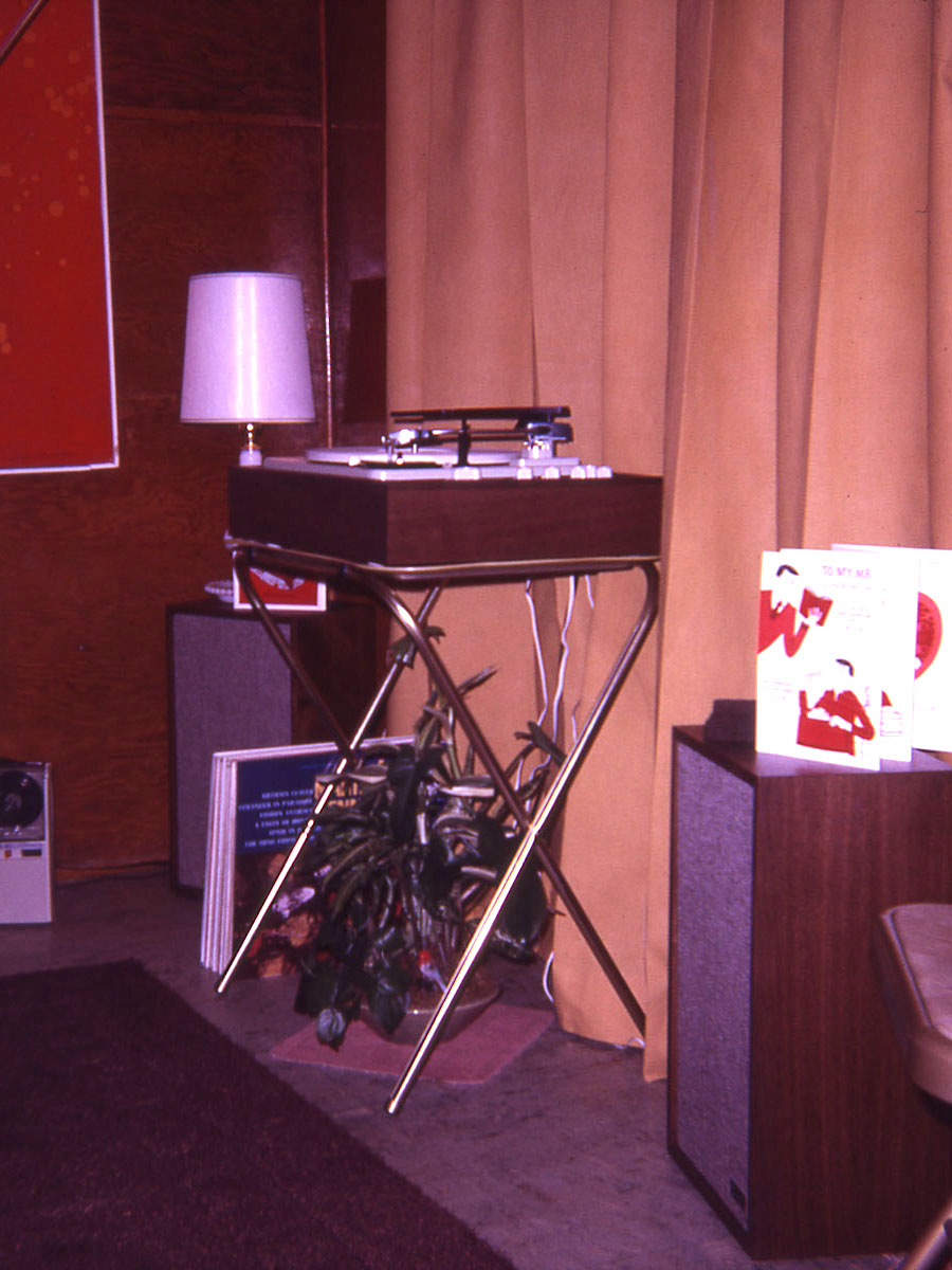

@Laro Is that matching drapery fabric on the speaker grill? That is retro. :) I'm glad to see someone who is 78 still willing to come on to the forums for research and advice. I have enough trouble getting my father-in-law to remember to how to access his email. ;)

Trebdp83: Thanks! The second photo to the last was in an 8 x 30 mobile home on a Maryland Navy base dumped by the army for being fire hazards . . . good enough for us sailors thou I guess! The last photo was after a couple of pay raises, then we bought our own new mobile home and had some fun with it! Yeah, I should send the bar back, but its kind of nice on certain movies! At our age thou, we don't care for it to be too loud . . . sometimes we place cotton in our ears when out at the movies . . . bet that looks good! LOL
