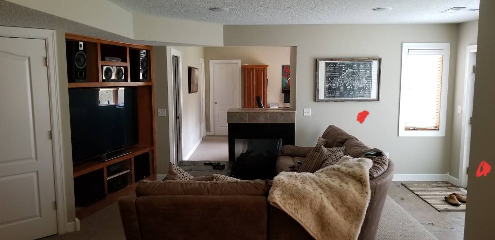

We recently moved, and I had to leave behind my well designed room, and walk into a new opportunity.
There new room has x4 Phoenix gold Atc6's in the ceiling, an oddly shaped layout, and a limiting built-in.
Long term, I'm working on getting ideas to resolve the built in, but this will most likely require construction of some sort.
Short term, is like to at least get into a proper 5.2 setup. The placement of the in ceilings it's very narrow, and straddles the front and back of the listening position.
My thinking is to try to find some decent speakers on stands for surrounds. Dealing with rear surrounds will be more challenging... Though I'm open to ideas.

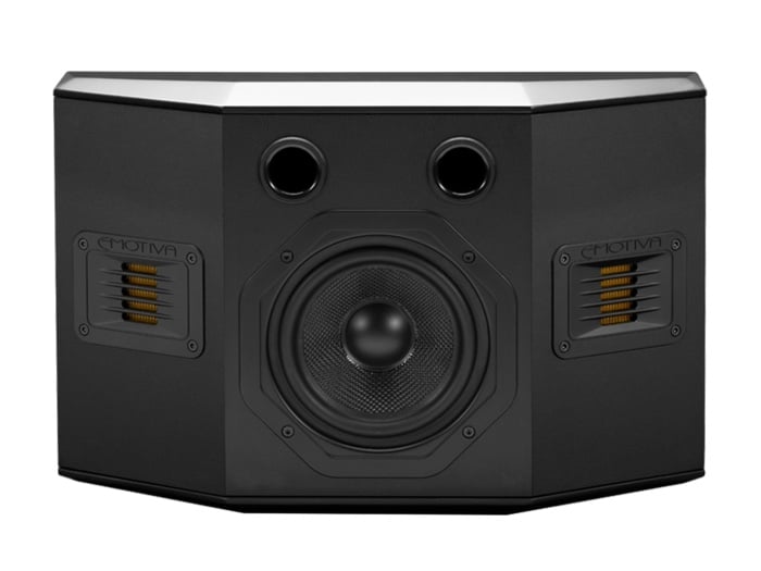

Interesting speaker with very flexible installation options and certainly makes a viable option in your situation
Emotiva E2
Emotiva E2
Awesome!
I'll add these to my research list.
Quick question: does the beveled face of these speakers cause problems with directionality? I am really familiar with this type of speaker.
Thanks again!

Dipoles generally are better creating enveloping surround then say speakers with all drivers on the face of the cabinet. With surround speakers directional sound is less important than from the LCR channels. Its likely using a bookshelf speaker like what is in your pictures above will be more direct but your space is not ideal for such a speaker in my opinion for surrounds. That however is just an opinion. The Emotiva E2 is giving you more options than the Klipsch or Focal so far as installation however it’s really a matter of taste. I would audition all three options if you are patient enough. Perhaps the dealer will have no problem with your trying them in your setup or hopefully will have a demo room for your convenience.

Can I ask you what you think about the photos I included. I put red dots where I am thinking about placing the dipoles.
Any tips or suggestions?

I agree. Definitely try out as many as you can reasonably, and enough to get a good idea of what you’ll like. Personally I loathe di/bipoles, but there are some situations where they can work better than a monopole. Rooms that are oddly shaped or very narrow can benefit from the diffuse sound since being very close to a speaker can make its position well known. Also rooms where they can’t be placed symmetrically can benefit too.
William Lemmerhirt
William Lemmerhirt
I think the red dot locations look pretty good. Then you might consider atmos if the angles are close.

I agree with the atmos idea in that room . It’s layout is way outside ideal but that’s the fun of this hobby namely overcoming the layouts that are not custom builds. The locations you marked should be fine. Maybe you can do something with those Phoenix ceiling speakers later. Those ones might be best reduced in speaker trim and used simply for ambiance!
