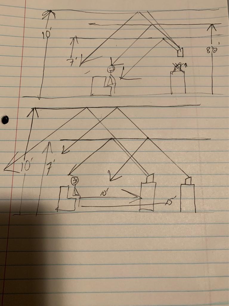

Do I understand you to say that you’re going to remove your surrounds and relocate them to height positions? That will definitely not work. If you’re talking about mounting the modules in the height locations, that might be a problem too since there’s a notch in the FR so sound appears to come from above and so you can’t localize it. Another thing about modules is they can definitely take some care in finding the angle to hit the couch. Think of making a bank shot. Here you can see how different ceiling heights and distances can affect everything.

I think a height mount will definitely be better. If the room is tight, you might find 5.x.x to be better than shoehorning a 7ch bed layer in there. 5.1.4 is better than 7.1.2 as well, but you need a little room behind the LP. Like 5-6 feet. For the modules, you might be able to tip them back, or forward to hit the right angle. At least until you get the height mount done.
