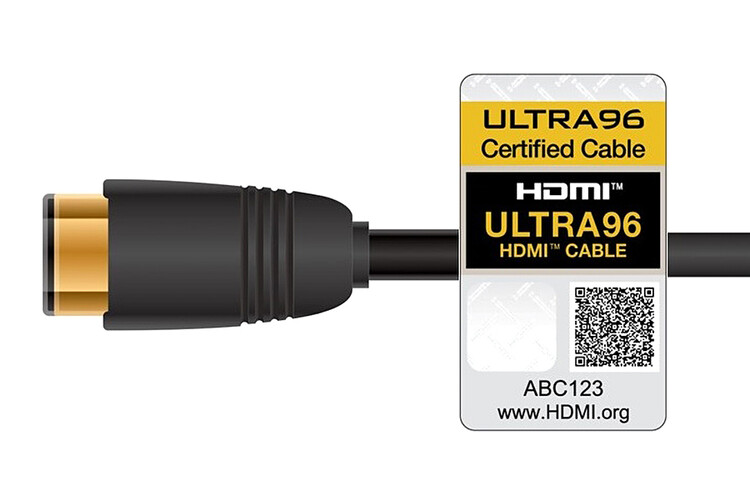

Wouldn't it be great if they actually stamped the release number on the cable instead of making us guess and wonder?

Ready to buy new cables?!!
One 2m cable will come together with devices, such as new consoles, monitors and TVs. Of course, there will be stand-alone cables for anyone who needs longer and more customized versions.
