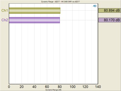

The 80 dB SNR at 1 Watt shown in the measurements is equivalent to 0.01% distortion, or actually a value even smaller since the measured ratio using the AES17 standard includes both noise and distortion (see discussion below), much better than the 0.07% that is stated for the Harman Kardon 3490 in the manual (at 120 Watts into 8 Ohms). Most people play their music at 0.1 - 10 Watts for home use; 120 Watts generates on the order of 105 dB - 110 dB sounds levels with most speakers, which is near the threshold for human pain. Was thinking of upgrading, but I'm streaming 24 bit/ 192 kHz digital audio over an optical cable to the HK 3490 from Amazon Music HD right now and it sounds pretty damn good! And the Cirrus signal processor means I can get nice sound staging for movies with only two speakers. Original bought the HK 3490 new back in 2009 and it's still going strong.
Signal to Noise Ratio (SNR)
harman/kardon HK 3490 SNR per AES17
"We measured the SNR at 1 watt power using no weighting for the worst possible measurement. It's important to know how quite a product is at low power levels to ensure the noise floor of the product isn't masking sonic detail. A number greater than 60dB at 1 watt is acceptable, while a measured response above 80dB is considered excellent or very quiet. The HK 3490 yielded around 80dB which is an excellent measurement. It's no wonder why the HK 3490 sounds so clean and detailed at low power levels."
PENG
The 80 dB SNR at 1 Watt shown in the measurements is equivalent to 0.01% distortion, much better than the 0.07% that is stated for the Harman Kardon 3490 in the manual (at 120 Watts into 8 Ohms). Most people play their music at 0.1 - 10 Watts for home use; 120 Watts generates on the order of 105 dB - 110 dB sounds levels with most speakers, which is near the threshold for human pain. Was thinking of upgrading, but I'm streaming 24 bit/ 192 kHz digital audio over an optical cable to the HK 3490 from Amazon Music HD right now and it sounds pretty damn good! And the Cirrus signal processor means I can get nice sound staging for movies with only two speakers. Original bought the HK 3490 new back in 2009 and it's still going strong.

Yes. I assumed the measurement I quoted actually refers to SINAD, that is to the ratio (signal)/(noise +THD). This is consistent with the AES17 standard that was quoted for this "SNR" measurement, although the standard actually includes ALL distortion, not just harmonic distortion. Otherwise, if these measurements don't include distortion, then the review failed to give any distortion measurements at all, which would be strange when reviewing an amplifier. Also, the measurements of max power were cut off at 0.1%(THD +N) or 1%(THD + N) instead of the more relevant THD alone, as Harman Kardon does in their specs, further making me suspect they grouped the distortion and noise terms. On the other hand, they do talk about a "noise floor" when discussing the SNR measurements, so maybe they removed the signal's harmonics due to nonlinear distortion - or maybe they were just hidden in the noise - but again it would be weird to publish a set of amplifier measurements without indicating distortion under normal operating conditions.

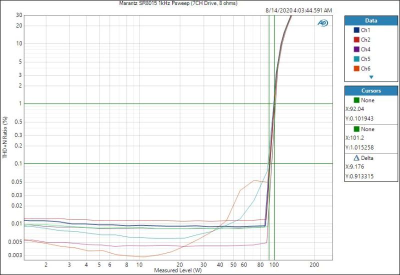

Yes. I assumed the measurement I quoted actually refers to SINAD, that is to the ratio (signal)/(noise +THD). Otherwise, if these measurements don't include distortion, then the review failed to give any distortion measurements at all, which would be strange when reviewing an amplifier. Also, the measurements of max power were cut off at 0.1%(THD +N) or 1%(THD + N), further making me suspect they grouped the distortion and noise terms. On the other hand, they do talk about a "noise floor" when discussing the SNR measurements, so maybe they removed the signal's harmonics due to nonlinear distortion - or maybe they were just hidden in the noise - but again it would be weird to publish a set of amplifier measurements without indicating distortion under normal operating conditions.
Now you seem to be mixing up SNR with SINAD.
As you know SNR is Signal to Noise ratio. In fact the graph you pasted in your post#129 does show the title (SNR) and that it was based on the AES17 standard, so I don't really understand why you are still thinking that it was SINAD.
In that review, Gene did not present a THD+N vs Power output graph (he stated the 0.1% and 1% used in measured the unit's power output, but no THD+N vs output graph included) that he typically would include, the most recent one he did was the one shown below, for the SR8015:
As far as I know, Gene typically uses the term "THD" and "THD+N". That makes no difference because if you know THD+N in dB, it is numerically the same as SINAD, other than the instead of -XdB, it will be just X dB, that is, without the negative sign.
I hope this clear things up for you.
I clearly stated why I thought it was SINAD. I don't know why you find my explanation so hard to understand. Please reread my last post.
Of course THD+N and SINAD uniquely determine each other; it's in their definitions, but most people relate to THD+N in percentages more than dB, since dB is primarily used by engineers.
I don't know "Gene", and was making assumptions about the measurements. And if you read the AES17 standard, it turns out my assumptions are correct.
Is that really so confusing for you?
No need to get upset, just asking questions. I was not confused, you are the one who wrote (in your post#129):
That original statement is the source of confusion. 80 dB SNR is 80 dB SNR, it is not equivalent to 0.01% distortions.
However, you are correct that in you response post#132 to my question, you clarified that it was an assumption you made and explained why, so my apology for missing that part of your explanation though your original statement in post#129 is going to to misleading to some of us, not just me.
It would have been easier to follow if you had qualify the 0.01% with "at least.." and add +noise to "distortions", but again, I do apologize for not re-reading your following up post before responding. We both know that if it was just distortions with noise removed, then it could have been less, or more than 0.01% unless if your assumption was correct that Gene actually measured SINAD.
About your "I clearly stated why I thought it was SINAD. ", I would only say, to me that graph was clearly just for SNR that did not include harmonic distortions. Again, he even specified it was "via AES17". If @gene actually meant SINAD he would have made it clear for us readers. Regardless, since it is your assumption, I have to respect that.., and move on.
And I'm just answering your questions, so indeed no need to get upset.
Below is the AES17 standard statement for SNR in the presence of a signal. It includes both noise and distortion. Hence my original assumption was pretty much correct if the AES17 standard was followed. As I suspected, that may be why no separate measurement of distortion was supplied - distortion is already included in the AES17 standard measurement of SNR that was supplied.
It's true that at the signal level tested (1 W), noise likely dominates distortion, so in reality the distortion is likely even lower than I surmised.
"9.3 Signal-to-noise ratio or noise in the presence of signal
NOTE The characteristic to be specified is the ratio of the full-scale amplitude to the weighted r.m.s. noise and distortion, expressed in decibels, in the presence of signal. It includes all harmonic, inharmonic, and noise components. It is identical to a measurement of noise in the presence of signal."
