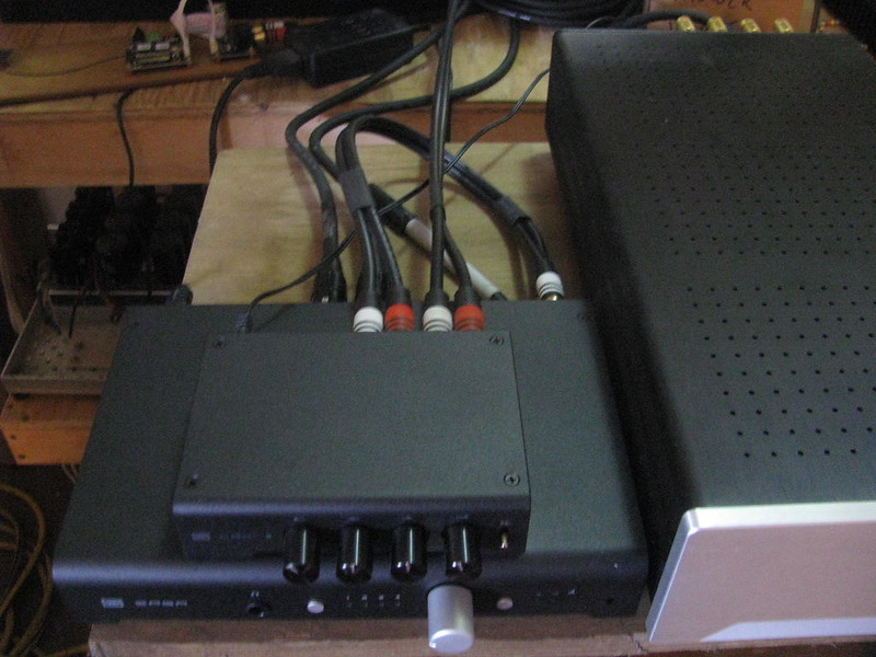

I added a Schiit Loki mini basic tone control unit between my streamer/DAC and Saga2 preamp for my hokey garage setup. I have full range speakers connected to it with no subs. The tone controls have a switchable pass thru feature so you can hear the difference between changes made and without. I rarely have to use it other than just a db or so on some songs.
