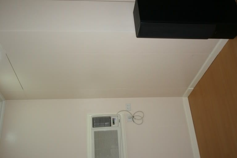

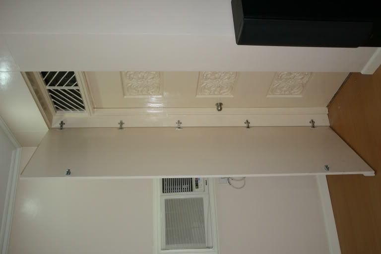

mike c
mike c
my room is made up of all concrete walls EXCEPT for a wall cavity where a door I don't use is, I covered it up with 3/4" plywood leaving a 6" gap between the door and plywood. is this affecting my frequency response?

Pretty much everything affects the frequency response in a room. Do you have a way to measure this accurately?

You have bare concrete walls, except for a sheet of plywood over a door?
The plywood won't have much effect - 3/4" plywood is pretty heavy stuff - but an all-concrete environment should be giving you huge frequency response issues. If it's a typically sized rectangular room, you would't have to ask - just play a series of sustained bass notes and walk around the room. You should hear very audible dips in the volume when you wall through a null.
When my room was still just an unfinished, untreated cube, I did rattle tests with a subwoofer, running the sub at high volume at sustained frequencies I knew would wake the room's resonances. There was no furniture in the room, nothing but bare, featureless walls and floor and the open metal framing of a soffit. The modes were unbelievable - I could have billed the room as a science demonstration for school kids. When my wife and I both stood in different nulls, we could talk to each other normally and the sound was little more than a thin, vague hum. If either one of us stepped out of the null, conversation became impossible, and if we stepped into a mode things became physically unpleasant, even with hands over ears. The test meter showed nearly 120dB in the corners (kids: DON'T try this without real ear protection) and well under 50dB in nulls. Very freaky. You don't get these swings in normal rooms because furniture breaks up modes and so on, but they can be startling otherwise.

what i'm worried about is the gap in between, could it be the cause of my 57hz dip? should I stuff that gap with insulation?

What if mike c made a accustic pannel door? Whould the air gap be an issue then? (assuming that it is now.) I guess stuffing it with some sort of insulation would be easier though.

Hey and when mike c opens it he would have a bass trap...;)

Um.. is the ceiling height just about 10'? That would be your 57Hz dip.
If that room is what it looks like - bare sheetrock everywhere - then you should be getting astonishing modes and dips, based almost entirely on the length, width and height of the room. That would dwarf any possible effect from the plywood.

my ceiling heights is 9 feet 4"
if that dip is caused by the ceiling height, it should be the same wherever I put my sub right?
so how do I treat for this?
