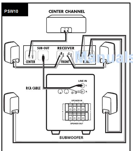

Hi there.
I own the Polk PSW10 Subwoofer and was wondering if I should buy a Y style RCA cable or just 1 to 1 RCA cable?
Thank you!!

My sub doesn't have LFE input.
You are correct. Your model doesn't appear to have a single LFE connection but a combines LR connection.
The owners manual shows a split Y cable. That's what the owners manual shows so that's your ticket.
The PSw12 does use an LFE, but not the 10. Good thing those are pretty inexpensive type of cables.
Back in the day when I had a sub like that I used a Y connector (just a little stubby thing) and it connected
to a single RCA coax cable that ran to the AVR. It works.
In addition to the picture, there are words that describe the connection options further:
NOTE:The PSW10 subwoofer does not have an LFE input. Instead, use either the L or R Line input (another hookup option is to use a Y-split cable and connect bothL and R Line inputs). After you make this Sub Out connection, turn the "Low Pass" filter fully clockwise. This will in effect create an LFE input
