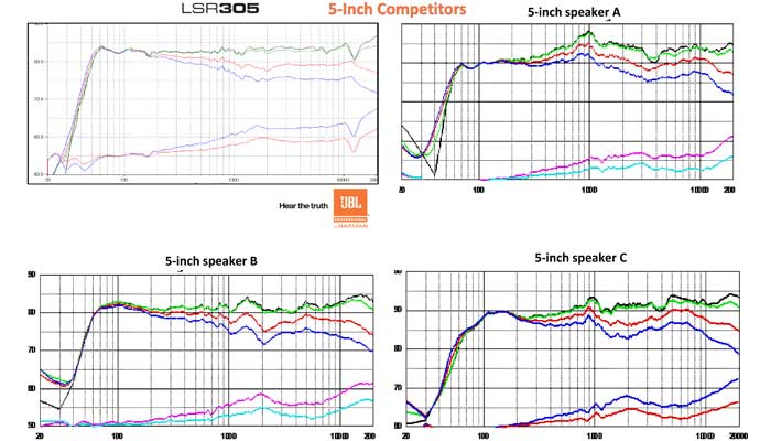

Think of the damage the Yamaha NS10 has done! Millions of sound mixes!
Here is a paper with a lot of measurements of different studio monitors. Some of them are very good, but others... people made professional sound mixes with these things. Just goes to prove Toole's point about the circle of confusion. The THX PM3 standard should have been pushed a lot more, it would have addressed some of these shortcomings. It doesn't have an all-encompassing solution, but it's a hood start.
Freakin Newell! James as you know that paper, while interesting, is missing among the most critical measurements of a speakers performance. The lack of polar data (unless I missed something) is sad. While I have no doubt the NS-10M is not a great speaker, without a polar response it’s really hard to say. You can design a speaker with a perfect axial response, ideal step response, and clean CSD, while still having bad sound. There are also a number of studio monitors that might seemingly measure well in that report but sound bad or measure poorly but sound good. We just need more measurements to actually know what is going on.
The note that the sound of the NS-10M was especially helpful for mixing rock seems troubling. Those speakers appear quite colored. Assuming that midrange peak doesn’t disappear off-axis then why would you want that? Even if you did, why not use a speaker with performance more like the JBL M2 and then artificially add the peak? It goes back to what I said earlier. Some engineers know there are flaws and mix around them. In this case, the implication is they are seeking out flawed speakers to mix on because it somehow sounds better.
I believe speaker "A" in that graph is the NS10. Looking at its first reflections curve, directivity index, and listening window, the direct axis curve pretty much sums up the off axis behavior. It's madness that these were ever used to mix sound recordings, let alone so many recordings.
While I agree, the nice thing about a consistent polar response is that you can eq that out and get a more neutral response. I think you know that I consider a higher DI optimal but I’ll admit a low but flat DI or gradually rising but smooth DI and a flat/smooth axial and first reflection response is good too. Seems like the high frequencies are less even in the 3-7khz range but not terrible.
I have to be honest the NS10M seems redeemable. Just needs some eq. Still they don’t match JBL’s monitors for similar money. It’s sad how many bad monitors are on the market and readily in use.
I still would love to do some kind of pro vs home monitor comparison to see what’s he best way to spend $500-$1000. I have a strong feeling that in that price range a set of powered studio monitors and a monitor controller would give far better sound than what you could get from the domestic end of things.
If we look at the THX standards page for powered monitors, none of them are terrible (except for that Avantone thing), so I think buyers these days have a good chance of ending up with good monitors, at least if they stick with the known good brands. I doubt that many studios still use the NS10. I agree that studio monitors are a safer bet for good sound than home audio speakers. That said, not every monitor is a gem, and there are home audio speakers that are easily accurate enough to be used as a monitor.
