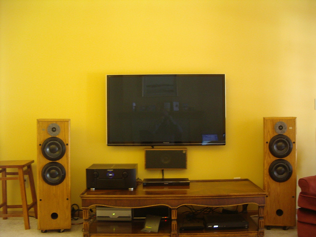

I have a set of the Jordan divers, but I don't think they are nearly as good as his first one the JW.
The JW is much more laid back.
We don't really need a totally full range driver, but one with excellent response from 200 Hz to around 10 KHz with good power handling.
The biggest limitation of the Jordan Watts driver, is that it is power limited and frail. The cone is basically foil and easily deformed.
However a pair used sensibly in a TL sounds excellent with a very natural perspective. It does not have a rise in HF response at the top of the range, but gently rolls off on the top end.
I use one at my Eagan residence for the center channel crossed at 90 Hz. Since it is a condo I can't blast it and it keeps up well. Speech is natural, highly intelligible and without shout. It blends well with the mains.
