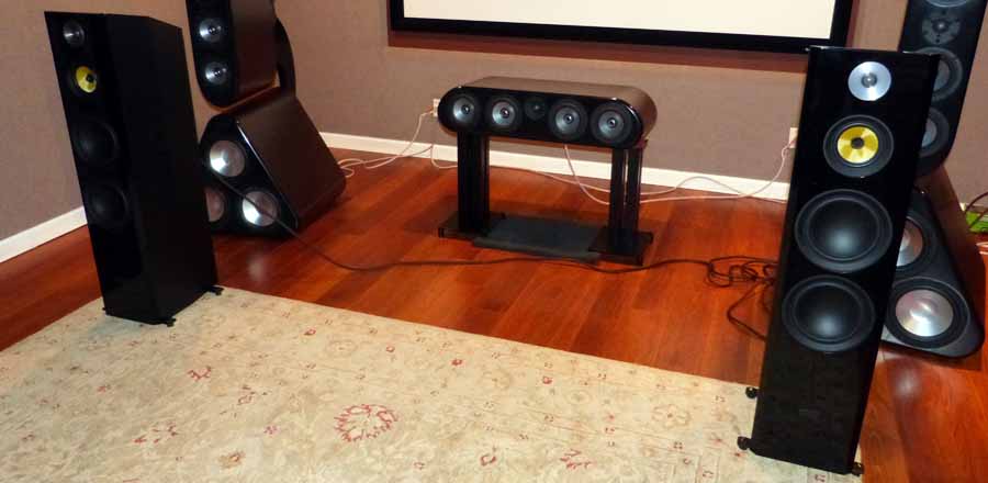

Hugo and I finally got a chance to check out the Signature towers Fluance sent to us for review. WE are both absolutely floored by the workmanship and materials of this product for such a modest asking price. These things are HUGE and constructed quite well too. Aesthetically they are quite nice and don’t look as imposing when looking straight on thanks to the tapered back.
On the installation side, there is NO mention of the outriggers and feet or how to install them. I kinda figured it out myself as you can see in the attached image but I’d highly recommend Fluance adding installation instructions in the owner’s manual. The magnetic grills are a nice touch but the magnetic force isn’t very strong and easy to knock off, especially when moving the speakers around the room as Hugo and I found. Be mindful of this if you have small curious children. I love that the grille isn’t made out of cheap plastic like you often see in products at this price point. I’m pleased with the extra thick front baffle of the speaker, flared ports and the binding posts. Impressive!
From a sound perspective I will tell you I’ve never heard a pair of speakers in this price range with such prodigious amounts of bass extension and output. Most impressively is how clean the lower registers are. The cones hardly move even when being hit with bass intense music at loud listening levels. I was unable to bottom the woofers which was a very nice surprise. I even threw a Japanese Drum track that absolutely tortures woofers and these things held up. They just love to play loud! Hugo and I both though these speakers threw off quite a large soundstage and sounded very real and lifelike thanks to the great bass response and incredible detailed top end.
The vocals were a bit unsettling at first. I felt that the midrange at times sounded a bit nasally which can be accentuated on female vocals. I think there are two reasons for this; 1. The tweeter level may be set just a tad too high, the midrange is crossed over too high which I will be investigating when I pull measurements next week. I was able to alleviate some of this by NOT toe-ing in the speakers. I found by facing them straight on with virtually no toe-in helped smooth out the mids and tame the top end. Putting the grilles on also helped this a bit. Note the highs are NOT fatiguing even though the tweeter may be a tad hot. This was welcome in jazz music as it portrayed a lot of detail but it was a bit strong on female vocal tracks.
All that being said, Hugo and I both believe this speaker is quite an achievement at its price point.
I haven't read the CNET review as I didn't want it to taint my first impressions of this speaker so I am not sure if I am in agreement with it or not.
Stay tuned fore more to come....
