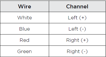

Problem #1:(Wiring)
The Fluance says to wire this way:

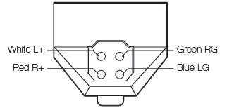

Whereas the Ortofon says to wire this way:
Do I wire according to what the turntable recommends or follow what Ortofon says?

For the wiring of the cartridge, the instructions are exactly the same for both Ortofon and Fluance.

First the wiring. The Ortofon and Fluance wiring are identical.

Mate Ortofon's wire function (not colour code) to the turntable's wire function (not colour code). I.E. L ch hot to L ch hot.
In this particular case, the colour codes for both cartridge and turntable tonearm do match, so no conflict.
