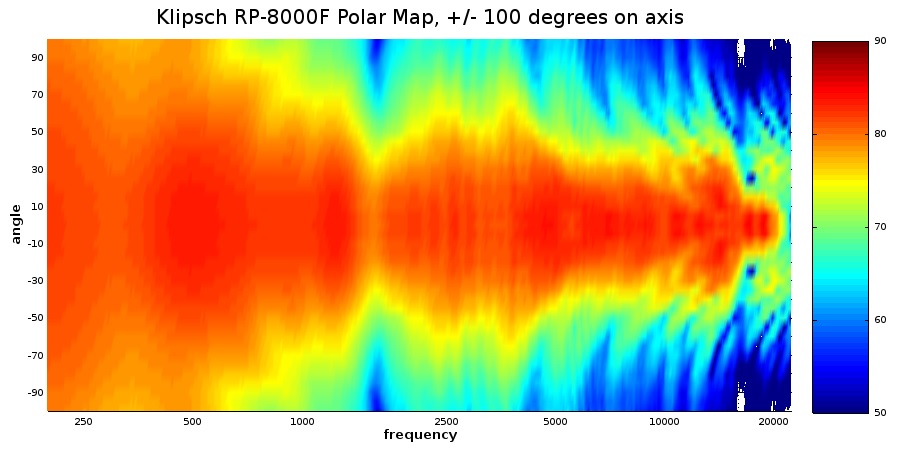

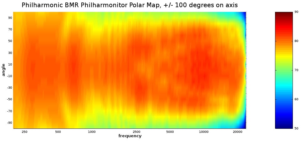

Try to think of soundstage more as a behavior type than a brand characteristic. Lot of brands make these type of speakers. A way to look at this kind of behavior is in polar maps of dispersion. For example, look how much more off-axis energy this speaker has compared to this speaker. There are advantages to both approaches, but if you want a wide soundstage, look for wide dispersion measurements. This is not just my experience, this is backed by psychoacoustic science as well.
