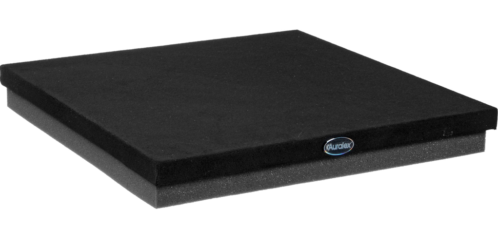

I got one of these because my Sunfire subwoofer like to go for long, windy walks:
There are many detractors of products such as this on AH, but it did indeed tame my sub's tenacious travelling tendencies and I am sure you could find something similar if the $50 outlay ($100 in your case) is not to your taste.
