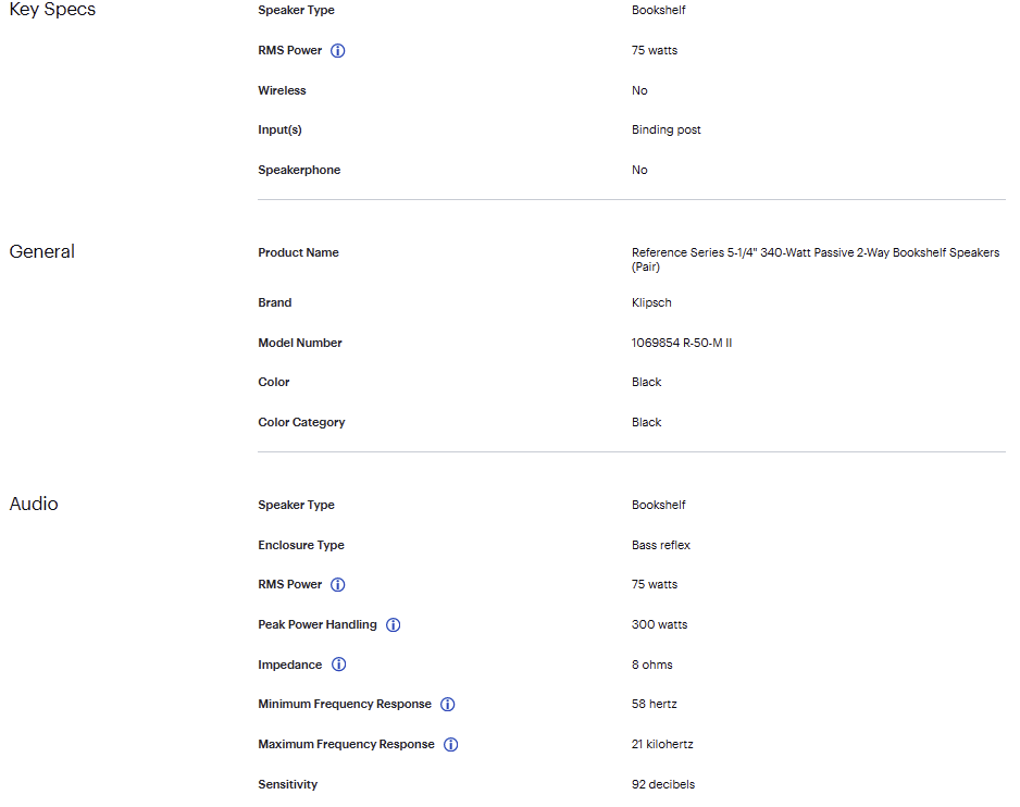

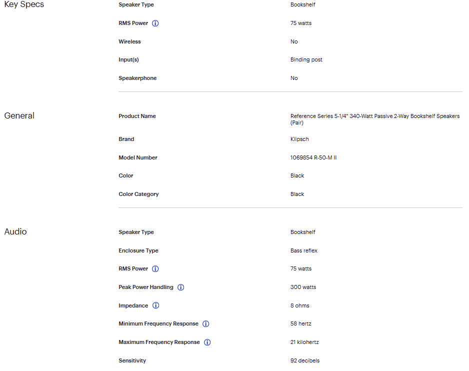

How about these Klipsch passive speakers?
Klipsch published a sensitivity of 92 dB for those speakers. Traditionally, they have over rated their sensitivity values. I strongly think they rather have a sensitivity of 87-88 dB. That is far from being sensitive enough taking account of your planned listening distance from them. IMO, you definitely need speakers with a real sensitivity of at least 95 dB.
