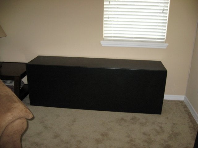

If the size is important then check out the small (on wallet impact) but mighty THT sub design
Barely could even notice it:
