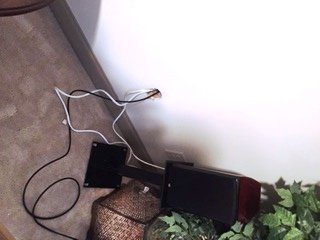

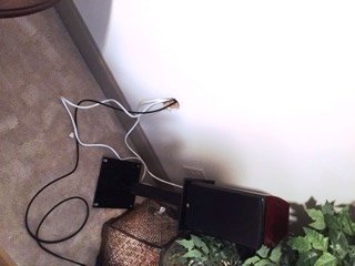

I just ran 3 wires (two surround speakers and a sub RCA cable) from basically a ft off the floor up to the ceiling and into the attic. I had to run each one separately, Getting a hole cut large enough thru the dbl 2x4 top plate framing in the attic was easy. Feeding the wire down an insulated wall and pulling it through the opening was not. Granted I don't do this every day, but it took 2+ hours! If you are coming thru an interior wall with no insulation...it's a 30 min job.
Concealer...that looks clean, almost like a small crown molding...my wife has OCD and major problems with wires on the walls, but I think even she could handle that.
Couldn't get the pic upright but you get the idea....this wire goes up a 9' wall, across the ceiling about 16' and down the TV wall.

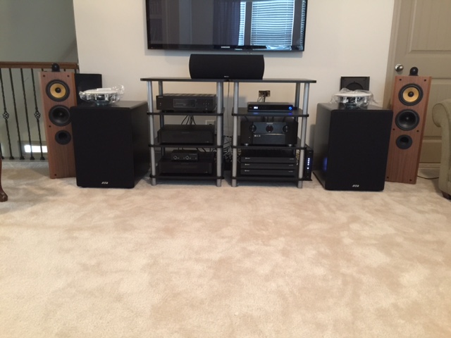

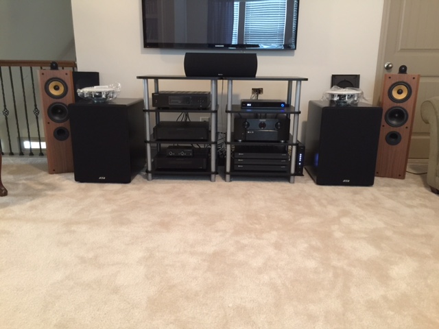

Off topic, but your last picture makes me want to move your B&W's more forward to be even with the front of your subs. The speaker on the right does not look ideally positioned back behind the sub and that chair. If this is an old picture and you've moved things since then, did it improve your sound?
Thanks...yeah, good observation. @William Lemmerhirt picked up on that last week. The left main has a speaker cable issues but mains were inched forward and subs inched back to bring them at least even now.
Not really. The B&Ws have been there for a while before I bought the subs and they image and sound about the same to me.
