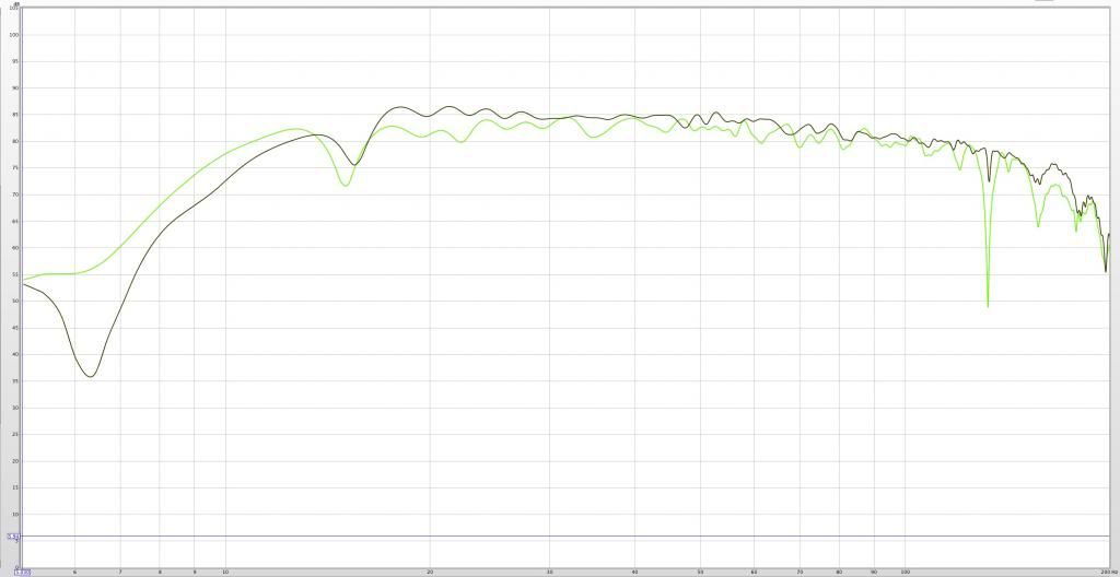

Spent a little time with the EQ's today. Didn't get around to the single 18", but this is the DO. Green is the rear driver and black is the front driver........I think. Or vice versa. No smoothing, from the LP.

The center, with 1/12 smoothing. Red is with Audyssey Flat, and the Blue is without from the LP.
