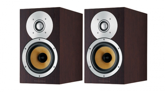

Keep in mind 'vintage' speakers tend to be from the 60's. I'm not sure if these are what you have, but this is what I get when I look for B&W CM1 speakers:
I don't think the Sonos stuff is anything of an upgrade. You have a decent set of speakers and receiver and the rest. Do you have it connected to a TV, or are you just using it for audio listening? Sonos kind of works with a TV, but it's a long way from an AV receiver.

I had a look on the back of my speaker, and while it says CM1, it is actually a B&W Concept 90 (circa late 1980s I believe). It is a CM1 connected to a CM2 dual woofer low end cabinet.
