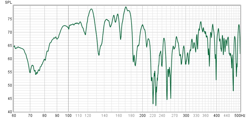

Ran some tones again making sure MultiXT was off this time. No change whatsoever. Right channel still playing at 52dB at 100Hz, 70dB at 80Hz, and 72 dB at 63 Hz. Left channel rolls off as expected.

Right, I realize that, but it is not 3dB down at 80 Hz and goes up below 80Hz before rolling back off. Something isn't right.
It's eq-ing below XO because there is still output to eq. That's what you asked. Small setting doesn't matter.

Switched speaker to Large as requested. Same issue (not sure why it would make a difference):

All else aside, given the Audyssey EQ correction curves posted and the RF response I am receiving, do we agree this is not normal operation by any means?
Have you tried moving the speakers in case it is a mode issue instead?

Its not, because if he connects the right channel to the left speaker, then the trouble appears on the left speaker.
His latest post now strongly suggests a non linearity in the right channel of that receiver.
I agree it is not normal. The question is cause. Obviously there is a non linearity somewhere.

I'm about to buy a new o-scope (been wanting one at home for a while), so I can take some voltage measurements at the speaker outputs at different frequencies and that will show without a doubt if the right channel crossover is not filtering properly, which I think we already know. But it will be nice to have some more solid evidence.
That will really nail it down. You will also be able to find where this is occurring by measuring the preots and the speaker outputs. I assume you also have a signal generator as well, as that will also be required.
