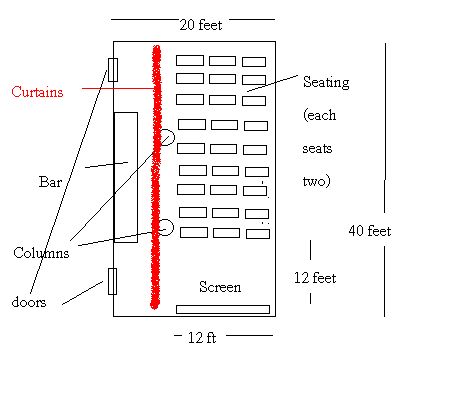

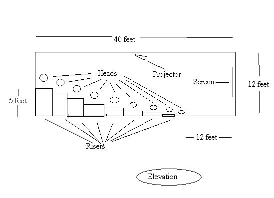

OK - more information. Attached are two poorly drawn diagrams.
The space will ONLY be used for screening movies, and there will be no "in and out" -the room will be closed and quiet during screenings. I've decided to make this a really dedicated room. Screw karaoke.
I am assimilating all the info. If any of you want to really get involved feel free to call me! 917.406.9192 I am looking for a consultant - if you are local to Brooklyn maybe you can get paid for your work.
Cheers to you all.
(still trying to attach....)

From just looking at the drawing, it looks like you might not have enough room for the rise between each row of seating to allow for that many rows. Nine rows of seating in 28 feet? :confused:
You need almost 10" to 12" rise between each row to allow full view of the screen. Otherwise the screen needs to be mounted pretty high on the front wall. This can make for some uncomfortable viewing in the front rows.

The risers are six inches - screen will probably have to be a little high for that front row or two. C'est la vie. Max width for screen is 144 inches - so 16*9 will get me a 144*81 (L*W) screen, I believe. Probably not great at 39 feet but you know- just doing my best here....

Yeah, of course it has to be a compromise. No one wants to sit in the very front row of a movie theater, but sometimes those are the only seats left.
You can fit a 165" 16:9 screen with those numbers. I would shave that down a good number of inches for frame/masking, etc.
