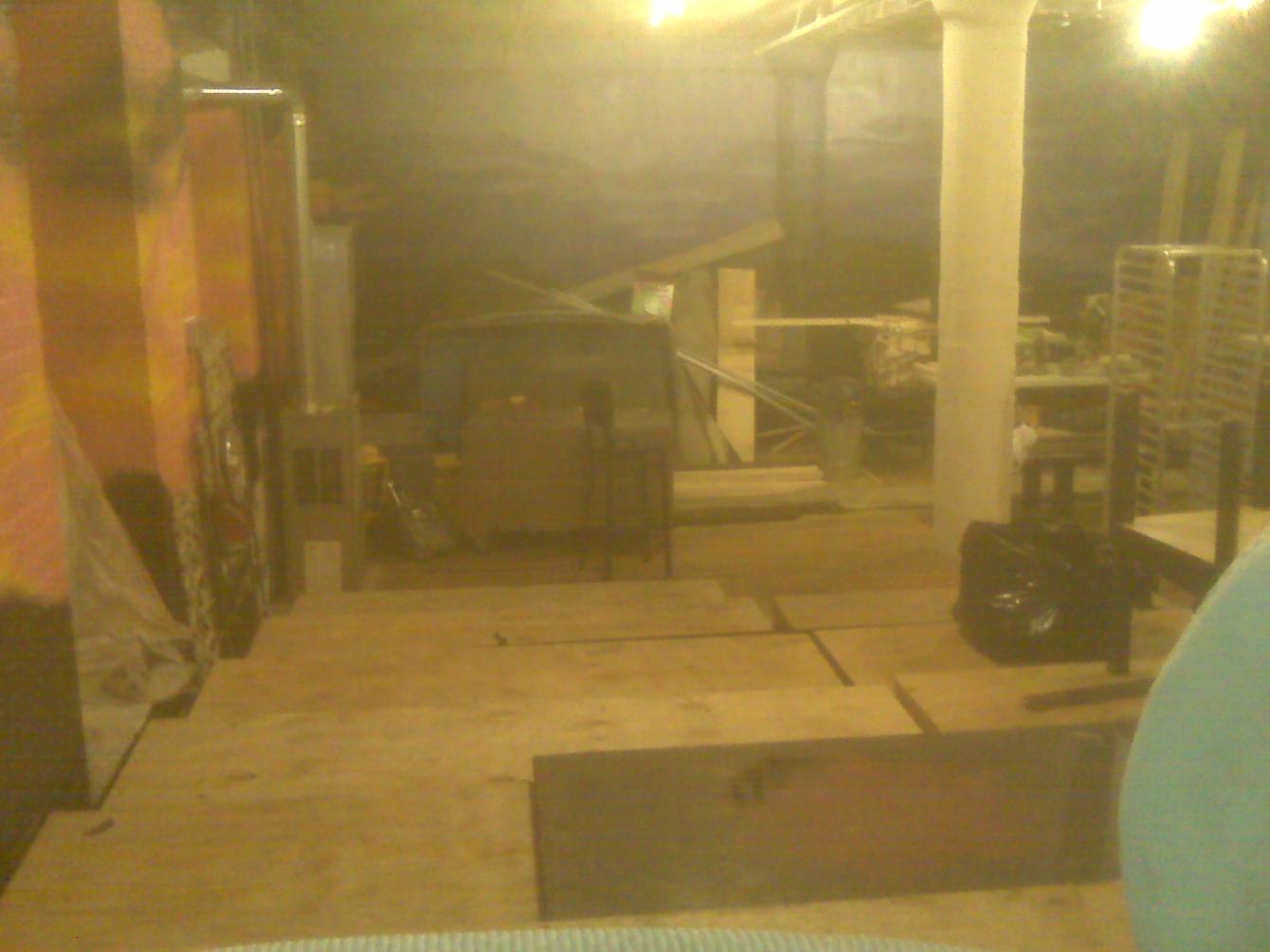

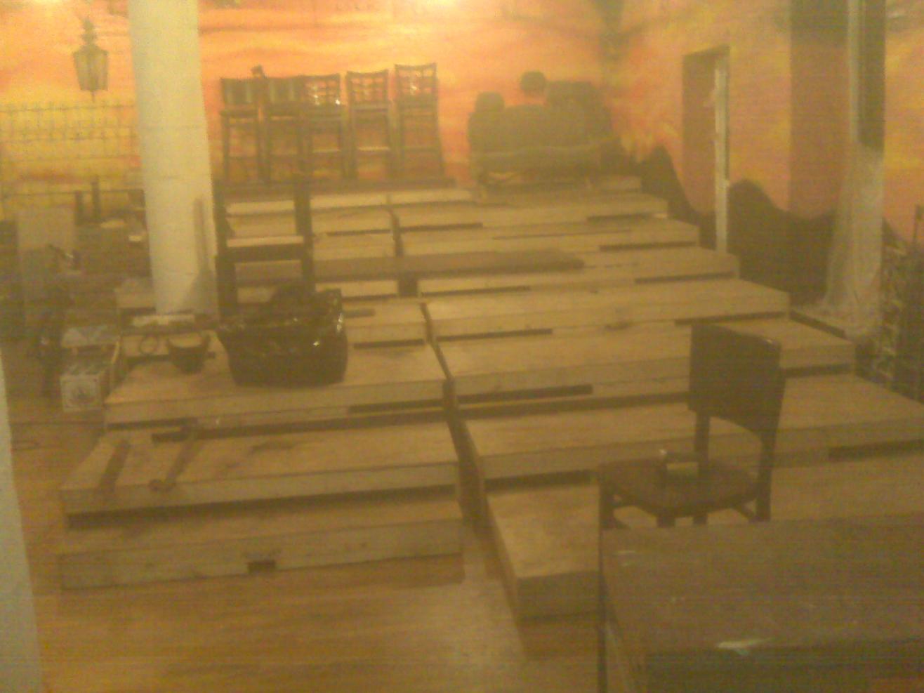

Update with bad pictures
OK - two images - one from the front of the room, one from the back. A theater curtain will run the 40 foot length of the room just outside the columns. The rake starts 15 feet from the wall and rises to a final floor height of 4 1/2 feet (9 1/2 foot steps) The max size of the screen will be around 180 inches diagonal.

I would guess you're not looking for the perfect theater experience in this room since it's a commercial establishment and not a home theater. I would also assume the theater will be running for more than five continuous hours every day. For that reason I'd stay far away from a single chip DLP projector that uses a color wheel. I would also assume the ceiling area where the projector will be mounted will get HOT. Make sure you provide proper ventilation for the projector to prevent premature failure.

As far as the screen, try to keep the height of the screen approximately 1/3 the distance to the central area of the seating. So if you're 12 feet from the screen, you would need an image 4 feet high. With a 16:9 (1.78:1) screen you would need a 100" diagonal screen. Keep in mind that the bigger the image the more lumens (brighter) the projector needs to be and for the most part the farther the projector has to be from the image.
To be honest, for an installation like this, I'd really recommend a professionally installed rear projection system. It can solve a lot of issues and not take up that much real estate in the room. But they are not in any way cheap.
The room will have some serious acoustic issues due to the room dimensions, materials of construction and unknown seating (amount of occupants). For these reasons I'd make sure the front three speakers are more than adequate to provide sound capable of being heard in the back of the room over people talking. Otherwise the people in the back of the room won't hear the dialog. Unless this room is going to have dedicated seating and a controlled access for people entering and leaving, the surround sound provided by rear channel speakers will become almost un-needed. Just my thoughts.....
