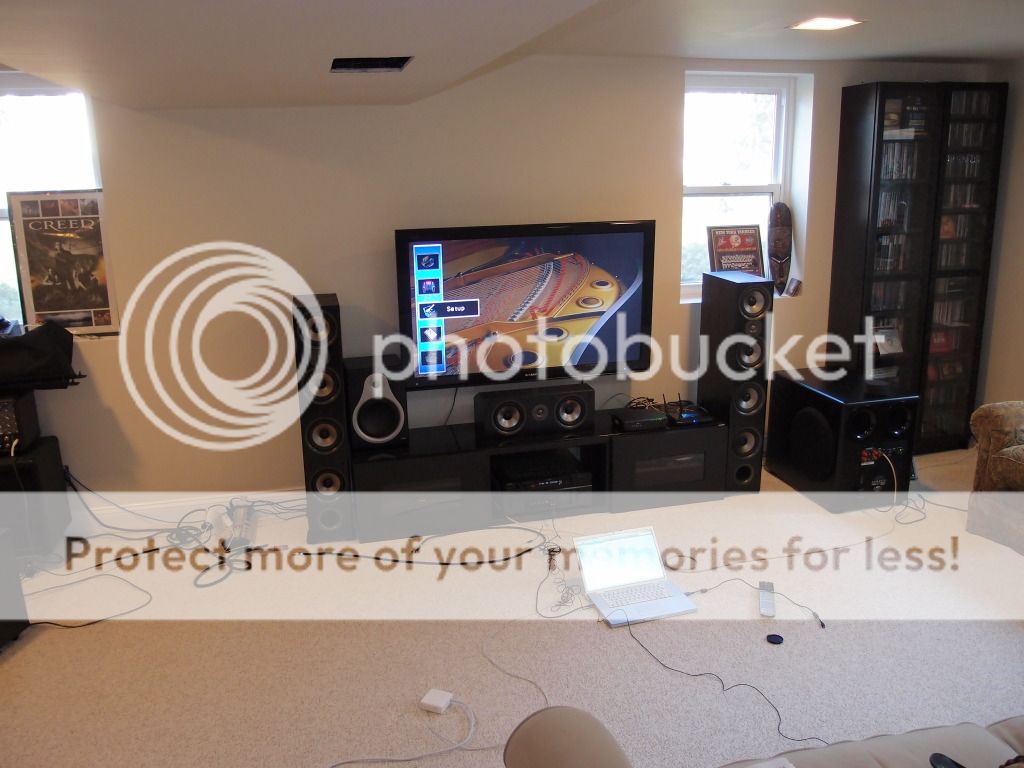

Okay so hopefully this will further the effort...I cleaned my room up a bit and took some pictures of where the sub COULD go as well as some wide angel shots to show the overall layout of my HT...
Where the sub is currently in the picture is the SECOND place I've tried to place it and is where it currently is. I moved it there after its initial placement near my listening position.
I will try the corner between my two couches next and see if there's an improvement- hopefully it will be as noticeable as the 2nd position over the 1st but we'll see.

With the RXA3000 all you do is run YPAO then go into the settings after & change them from large to small with a crossover of 80hz (to start with) you can have a crossover with the speakers to large because nothing is getting crossed over instead the whole signal is going to speakers. If you have them large & turn on double bass the. You may be able to adjust the crossover. In that case the speakers would still get their whole signal range & everything below the crossover # will ALSO go to the sub. So the <say80hz is going to both sub & speakers. Dont do this because bass will get muddy. You have a VERY capable sub. Once its dialed in correctly it will sound its best with speakers at small & a crossover somewhere between 60-100hz depending on taste.
Is that sub brand new or used? If new then it needs to break-in. If used then you need to place it right & get it set up properly! The location it is in the room will make ALL THE DIFFERENCE. If its placed wrong, then the frequencies will cancel themselves out & the bass will be abscent at your seat.
Try each possible sub location. Run YPAO at each spot & give a listen for a while at each spot. I know it can take time doing this but the effort is so worth it. Sometimes the bass crawl doesnt reveal the best spot as well as you might hope. Dont fret though, we'll get you to a point where youll understand this subs potential!!

I see that you have your livingroom set up so your viewing across the short span. Have you ever thought of putting your TV on the wall so your looking down the long way? Its always recommended to have your sight going the long way. In this case you could have your couch kind of dividing the space so when you setting down, the staircase is to your right. Then your sub could be in the front corner. Just an idea!!
Have your sub with the ports facing the rear wall & the driver facing into the room. If you want more slam for movies run the sub in MaxOutput mode. This will also give you more headroom & more dBs above 25h where it counts the most.
Your RXA3000 is a great receiver with tons of EQ features. Once you find the best location for the sub, get an SPL meter & use the HSU test tone CD. Tracks 9-21 are 16-250hz warble tones. With meter setup ear level at your main seat, play each tone & write down the readout. (to compensate for the meter being off at lower freq: add 12dB to 16hz, 7dB to 20hz, 4dB to 25hz & 2dB to 31.5hz for actual dBs) then use the different adjustments on the back of sub to your advantage. On top of that use the Parametric EQ in the receiver to bring down your peaks. Try to get as flat as possible to start with the.
In the RXA3000 after you run YPAO go to the Parametric EQ section. YPAO defaults to the Flat setting. Copy Flat to Manual & the. Go to Manual. You will have the exact YPAO settings there so you have a good start & then tweak from there. I have the RXA2000, i leave the speakers pretty much where their EQ is at. I do bring the higher frequencies down a bit because it can make my speakers a little bright. I do however reset the Subs EQ before i measure with the CD/SPL Meter. Then i adjust the EQ on the sub to like i said bring certain frequency peaks down.

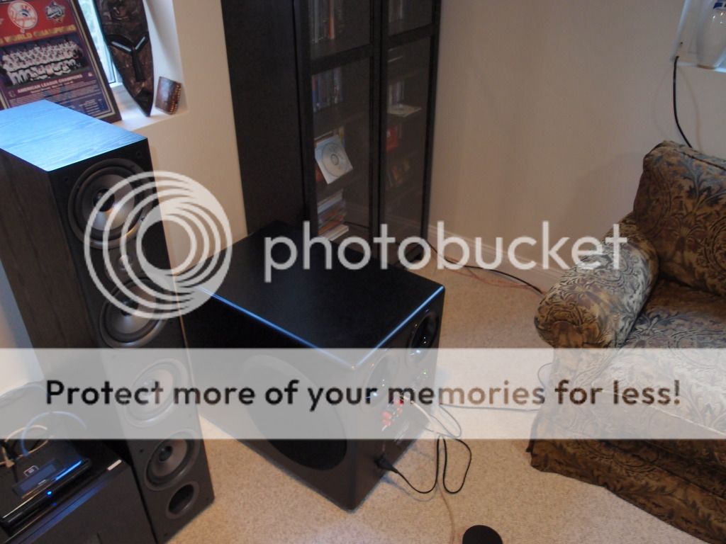

right now the sub is in the corner b/t the two couches as you can see here
this is the 3rd placement i've tried so far and has been THE BEST by far. i've heard the corner of the room near the listening seat is usually the best. i think what you said about "canceling frequencies" was definitely happening when i placed the sub in front of my main LP- the driver was moving but it didn't sound like it! lol
