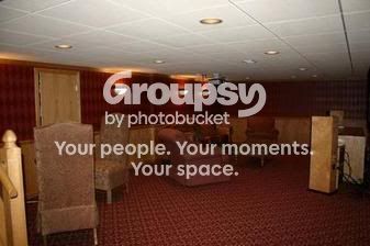

Jack, This is in the basement. I know you have seen it, but here is a pic for those who haven't ...
The speakers shown are the Onix Ref 3's, but the 2.4 i's and M80's are there now.

Simply gorgeous, Craig! Good work by you and the missus.
Thanks, Guys. You may rest assured the only things I added to the decor was the audio products. My wife did all the decorating. :)
I love how that room sounded. Or, rather, how it didn't sound. That's a very dead, but not completely dead, room. And, when we did some listening to music down there a month ago, I was very impressed how little the room affected what I was hearing. IMHO, it gave me a really accurate idea of how the speakers sounded.
