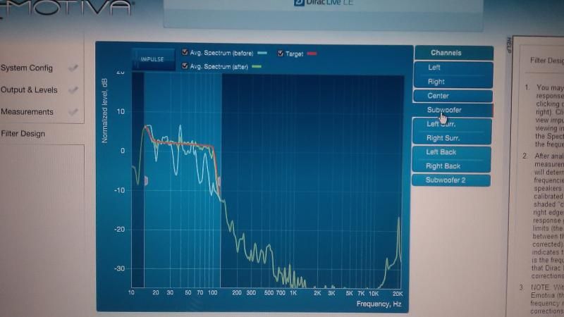

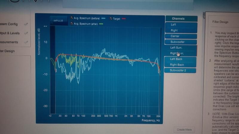

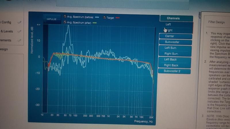

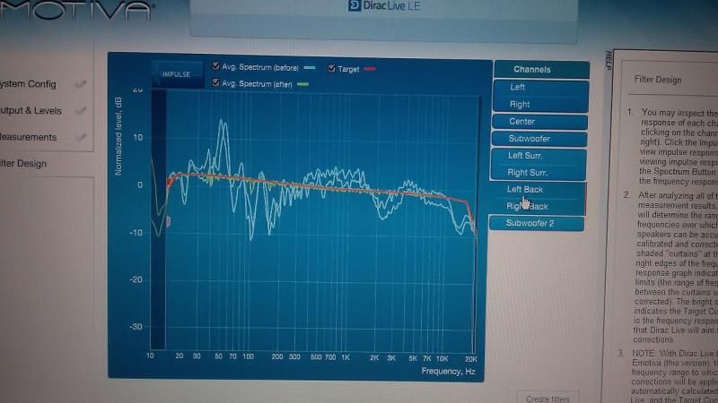

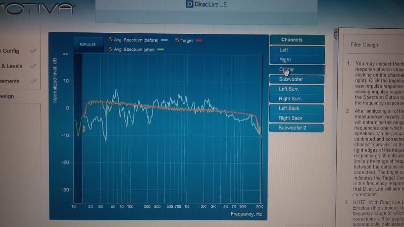

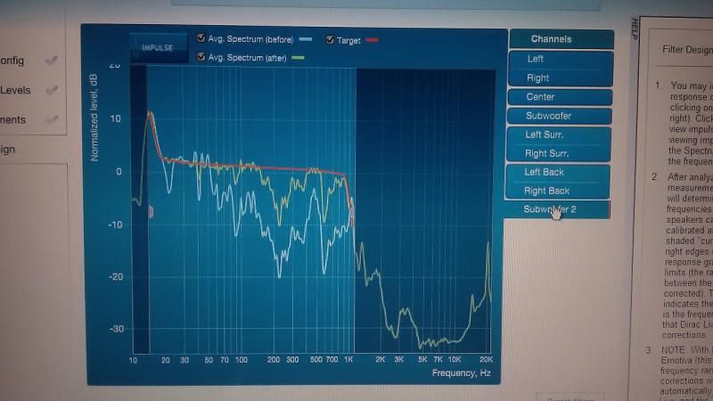

Here are the graphs with what Dirac heard and calculated for corrections for my speakers
Fronts
Center
Surrounds
Backs
Left sub
Right sub
