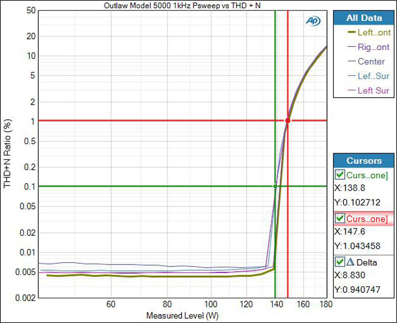

Especially impressive are the THD+N spec for 1kHz powersweep with all 5 channels driven. That looks like about 0.007% or better up to 130WPC! That reflects a quality design/build!

PS, that 2 channel driven @ 8 ohm power vs THD graph is pretty impressive.

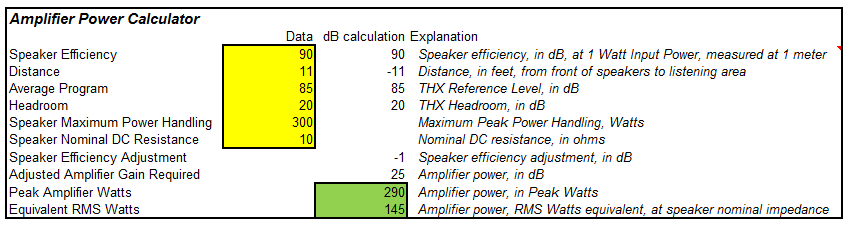

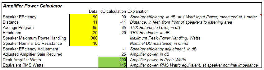

Hmm, lets do the math. Lets say an avg sensitivity consumer speaker is 88db/1watt/1meter and an average listening distance is 10'. In this scenario 150 watts will only give you 100db. It would take 475 watts to hit 105db. Sure, it doesn't take a 475 watt continuous rated amp to hit 105db peaks, but it will take around that much to do it clearly with minimal distortion and compression, and thats not even allowing any headroom. 3db of headroom requires twice the wattage. THX reference level is no joke, it takes substantial amplification (again talking typical consumer speakers) and very robust speakers.

Your math doesn't seem right. Try this calculator:
http://myhometheater.homestead.com/splcalculator.html
I can assure you that the above linked calculator is correct as I checked it with the spreadsheets I set up for such calculations, though the room gain part is obviously just some sort of room of thumb.

Thats the calculator I just used to give you those figures! Type it in and see. Put speaker placement to "away from wall" which is 4 or more feet which is good practice anyway. Number of speakers to 1 because where talking individual channel peaks.

That is the calculator I just used to give you those figures! Type it in and see. Put speaker placement to "away from wall" which is 4 or more feet which is good practice anyway. Number of speakers to 1 because where talking individual channel peaks.

So basically, when you set up your AVR, or AVP+MCH Power amp, you do set up/calibrate each (one channel at a time) speaker to give you 85 dB average at the main mic position. That is necessary for calibration purposes because you have no way of predicting how all 5 or 7 speakers would give you on moment by moment basis so there is no way to do any compensation for 2 speakers or more ahead of time. After running set up, you can expect your system to provide 85 dB average and 105 dB peak spl at you main listening/mic position. As mentioned above, you will have more than one speaker working, especially during the 105 dB peak moments.
Good points, thanks for linking your sources. I think we pretty much in agreement on this for the most part.
I do interpret the THX spec a little differently than you do though. You seem to me looking at AVR specs, Im talking about the overarching THX theater spec, which has nothing to do with "modes". Its admittedly a little vague, but the way I understand it its possible within the THX spec to have 105db peaks on any given channel.
From the Acousticfrontiers article you referenced:
"1. Speakers and amplifiers must be capable of 105dB peaks
If the playback chain is calibrated to produce 85dB for a -20dB signal at the listening position then the speakers and amplifiers could be asked to produce 105dB for a 0dB signal."
I read this to mean every speaker and every amp channel. Its within THX spec to have 0db signal on any channel right?
From HometheaterHifi.com:
"Reference level is by any definition, objective or subjective, quite loud. It basically mirrors the dynamic range of the studio system, which in the case of all movie sound tracks, is 105 dB. Any single channel of the system is calibrated to play 0 dB FSD (the loudest sound the sound track can contain) at 105 dB (115 dB for the LFE channel)."
IMO this one is pretty clear that where talking about per channel SPLs. Now, realistically full on 105db peaks will be pretty rare, but it does happen. If you want to be 100% sure that your amp stays below clipping you need to plan for the worse case scenario.
Here is a AVSforum thread on the subject, where a user with 6000+ posts states:
"Reference level means peaks of up to 105db from the main channels and up to 115db from the LFE channel." And no one disagreed.
http://www.avsforum.com/forum/113-subwoofers-bass-transducers/1252556-what-reference-level.html
If your interpretation is right I'd end up with some extra headroom. On the flip side if my interpretation is right but your system is only capable of 105db cumulative with 5-11 channels driven and it turns out the THX spec actually does allow 105db per channel you will end up regularly driving your amp grossly into clipping which will wreck havoc on your sound quality and your gear. You better be pretty sure about that interpretation! Id rather be safe than sorry.
I don't think anyone is really arguing my original point that many entry level consumer amps are overrated, especially at 4 ohm ACD, and that many Audio publications don't tell the whole story with there measurements. It seems that they don't want to ruffle any feathers. At the end of the day more realistic ratings can only help the consumer not hurt.
Anyway, it was a fun discussion. That said this thread derailed a long time ago and its largely my fault lol. This will (hopefully) be my last post here but maybe Ill start another thread for this kind of discussion.

PENG, to me its pretty clear that all those quotes on THX spec are saying IF you calibrate an individual channel to 85db @ -20DBSF, that channel will be asked to produce up to 105db (peak, whatever that means in this case) in playback. I certainly don't see anything to the contrary. We may have to agree to disagree on this one. I say again though, if you make the assumption your making, and your wrong, your in for a world of hurt because that makes a massive difference on wattage needs.
As far as being derailed I just mean that this thread has gone far from being about the UPA500. ill start a more general thread and send you a link :cool:
Seriously, last post this time haha.
The reference level of 85 dB THX referred to was clearly meant to be average spl. The 105 dB peak they referred to is not so clear in terms of whether they meant the maximum spl measured with a meter capable of recording peaks, or the maximum average SPL for a short duration....
"Many people also make a simple mistake which effectively doubles the size of amplifier required. Using the online calculators they enter follow a process of trial and error to determine the amplifier size required for 105dB SPL. The issue is that our THX requirement is not for 105dB continuous output but 105dB peak output. More on this later."
I am not sure about that and I think that extra 3 dB should be ignored in order to be on the safe side, unless I can find evidence directly from THX that supports the author's interpretation. I brought this point up just for awareness and discussions.
AFAIK, that's the commonly accepted understanding of how it works, i.e. 0dBFS = 105dB peak, not RMS. Indeed, the example given here:
http://www.acousticfrontiers.com/2013314thx-reference-level/
lines up almost perfectly with a simple mix and match of other THX Ultra 2 hardware:
http://atlantictechnology.com/product/6200e-lr/
90dB sensitive, 6 ohm nominal
https://www.soundandvision.com/cont...cessor-and-dta-701-amplifier-ht-labs-measures
155W into 2 ch @ 8 ohms w/ 0.1% THD+N / 230W into 2 ch @ 4 ohms w/ 0.1% THD+N
Even if you bump up to the 1% numbers for the amp, you're not getting another 3dB worth of headroom out of it.

Just when I think I'm out... They pull me right back in hahaha
So your saying the 105db is peak as in the peak of the waveform? This would be equivalent to 102db RMS, right?
That's my understanding of it. THX doesn't exactly go out of their way to release technical documentation, but looking at how AH does its room rating protocol for subwoofers, that also ties into 105dB (or 115dB for LFE as the case may be) being an instantaneous peak figure, as opposed to a short term RMS number.
