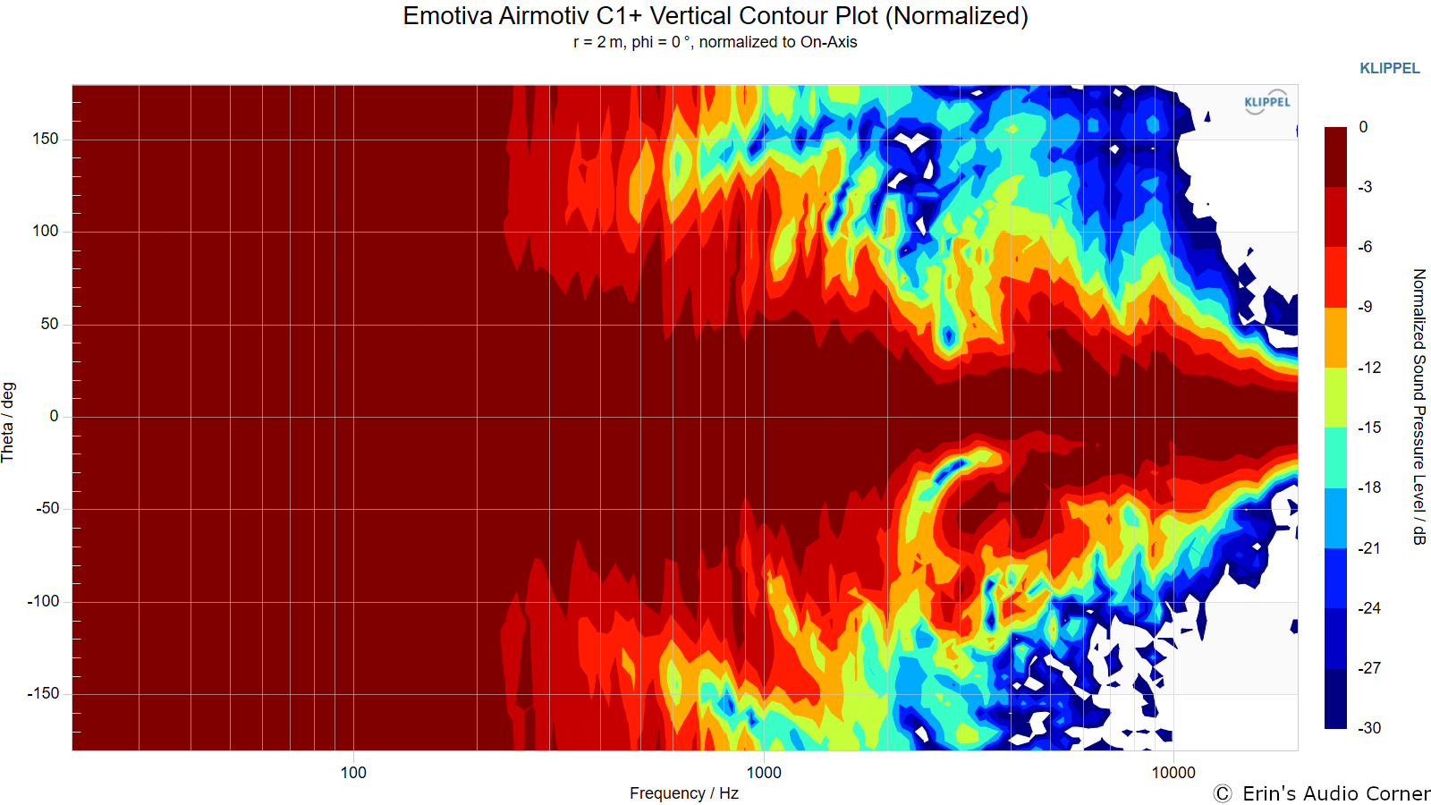

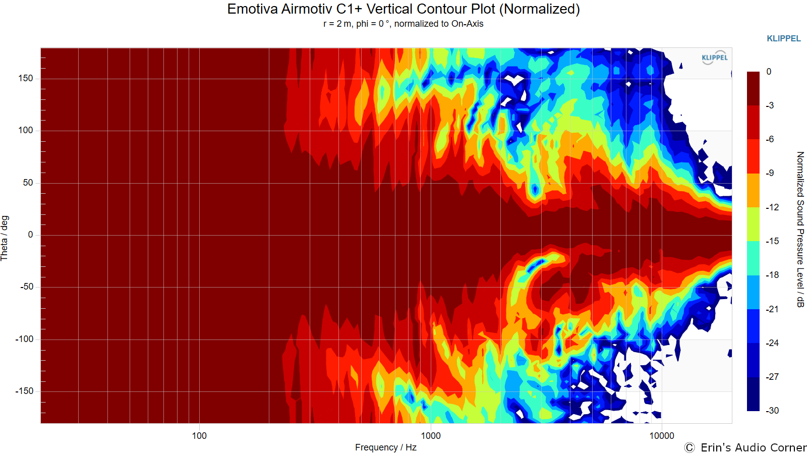

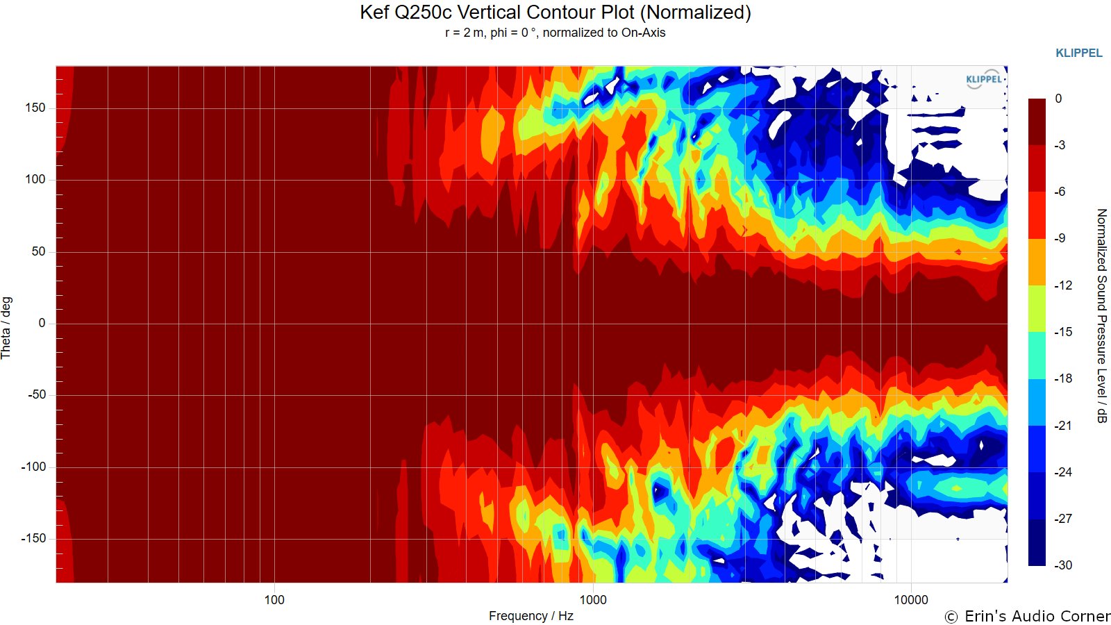

"The Emotiva C1+ center channel speaker has excellent vertical off axis response." Hmmmm...
VS the Kef Q250C
VS the Kef Q250C
To be fair, its not bad vertical dispersion. Most users will be setting it under their display, and there the Emotiva center gives you at least 20 degrees of smooth response above the tweeter, which is where you would want it the most. There isn't anything really wrong with its vertical dispersion unless you were to mount the speaker above the display.
I think that was Kini's point, as that is exactly where that Speaker got placed; tucked into a cubby above the display. :(
