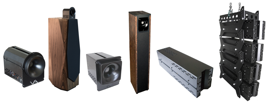

What do you think about this?
Information and video link: vigeraudio.livejournal.com
Electric-Arc Loudspeaker - The innovative solution

There is nothing new under the sun. The first ionic discharge speaker was the Ionofane, introduced with great fanfare by Fane acoustics in 1965.
These keep being reintroduced and dredged up every few years. They work by creating a modulated electric wind. They create this by modulating a sharp point with a very high voltage (millions of volts). The sound is produced by this modulated electric wind.
Unfortunately there is one huge draw back. They create vast amounts of toxic ozone. Ozone is toxic to humans, especially the lungs and is a weak carcinogen.
The other problem is that when they malfunction, which is frequently, they do so violently like a giant firework with significant risk of injury and property damage.
The attraction is that there are no moving parts. However air has mass so there is transfer of energy from electric to mechanical.
I can assure you they won't be allowed to sell any here.
How would you like to have a couple of these babies in your living room?

About OZONE ... Read chemical encyclopedia, basic literacy. Ozone at temperatures above 158F breaks, cold plasma is very difficult to obtain for ozone. For use powerful arc lamps (efficiency = 1%), where a lot of ultraviolet light, and it adds an oxygen atom. very not for long!
Information about the absence of mechanical parts, to overload as much as you do not break in touring work is important. Ribbon afraid overload and expensive + amp? Price?
I think the sound of EAL much better than any of-Ribbon. Type PRO work in a group, pick up the required number and receive power in high fidelity sound.
