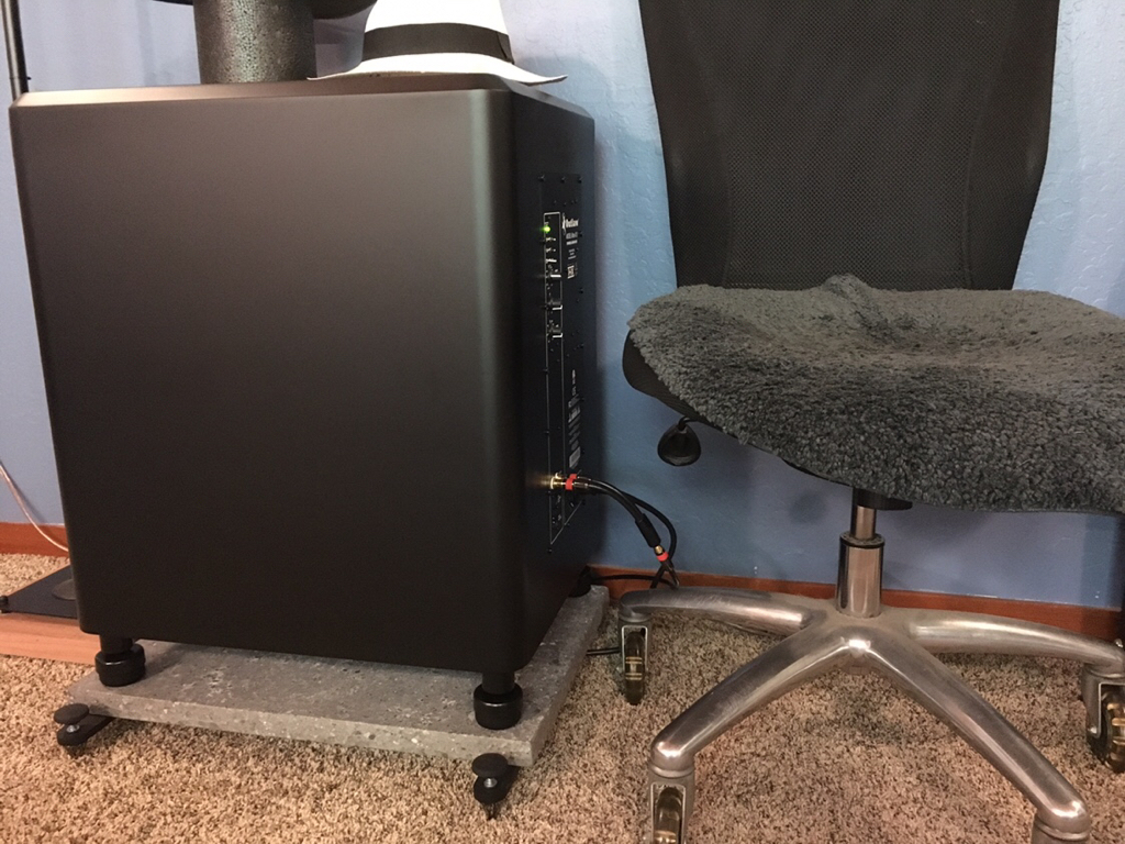

- You don't have to put the sub in your seat, but you need to put it as close as possible... so move some furniture if you need too.
Or put it in your seat... (mine is a 100#+ down-firing beast. I just moved my chair away).
- I already told you to be patient. Keep your Mind and Ears open! Listen along a wall first, and move into a corner. This helped me out when listening. Corners will amplify bass (the premise behind corner loading). The most important thing is that you learn to hear the subtle differences! And they can be subtle. (Except for when they aren't, but those tend to be extremes.)

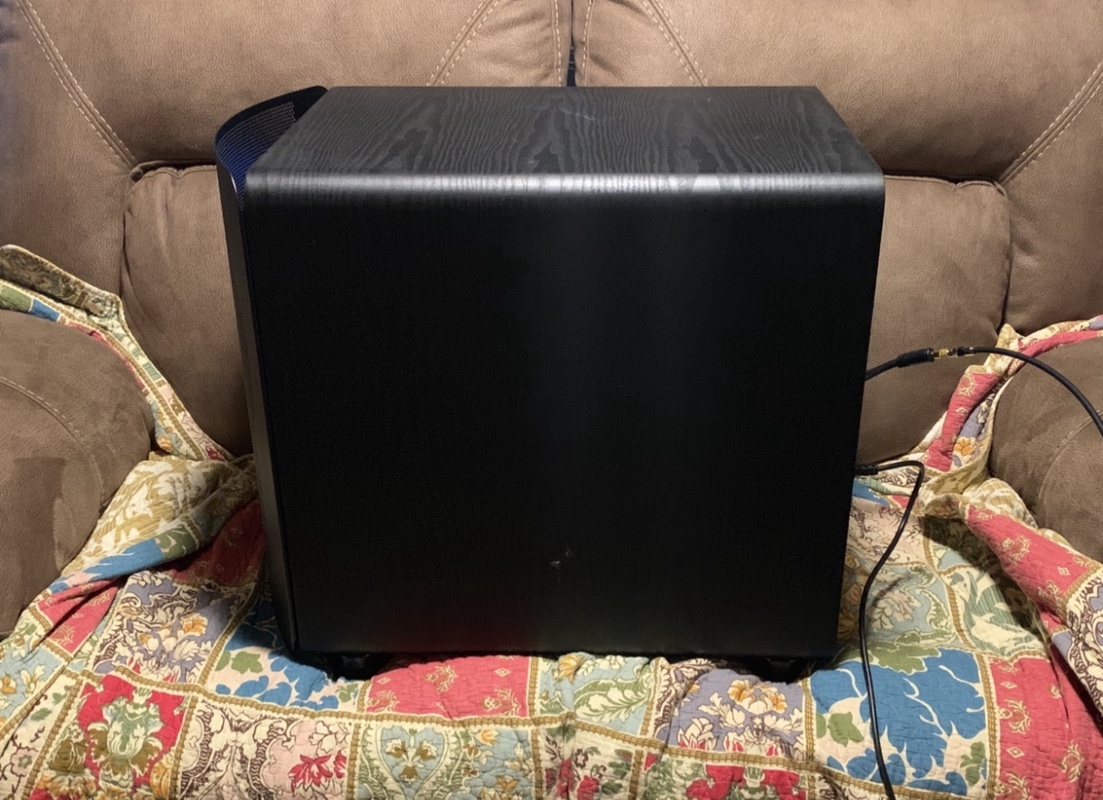

- The best place for subs also is not necessarily the front wall or corners. (Keep your mind open.)
- Depending on the size of your room, volumetrically, you may need to consider a near-field placement (behind the couch, as an end table, etc. (Keep your mind open.)
