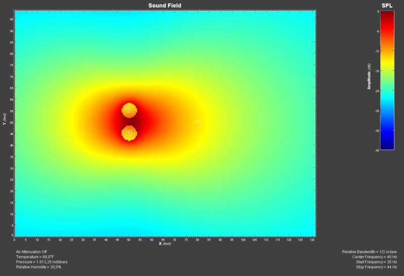

DUAL SUB´S FIELD RESPONSE # 1 of 3
In these acoustic predictions, We have a 100´ X 130´sound-field,
The reason for this is that I want You to understand how low-freq´s can expand.
This is a plan view projected with two subwoofers working together @ 40Hz, with the same specs, amps, and x-over filters.
Each one has 2 X 18" speakers, with a freq response of 28 Hz - 150Hz @ +-3dB, with a 600W amp.
All the sub´s have the same coverage (omni) so We can expect almost the same behavior in big or small speakers.
At the front ( X to the right ) is a microphone which can give us the freq response in that field, at 68º F and 20% relative humidity.
You can see that they expand to 360º when they are mounted one against the other.
In number 2 and 3 of these predictions You will see what happens if You separate the sub´s from each other.
Energy collapses to the center and starts to have deep cancellations in some areas, and sums energy in others,
Imagine that the reflected sound acts as a "virtual" speaker that is working in a different phase and time, against the original source.
Note: I am NOT calculating the reflections ( wall´s, floor or ceiling ) in this case, but if anyone would like to see another prediction, maybe with other dimensions, or freq´s, Just let me know !

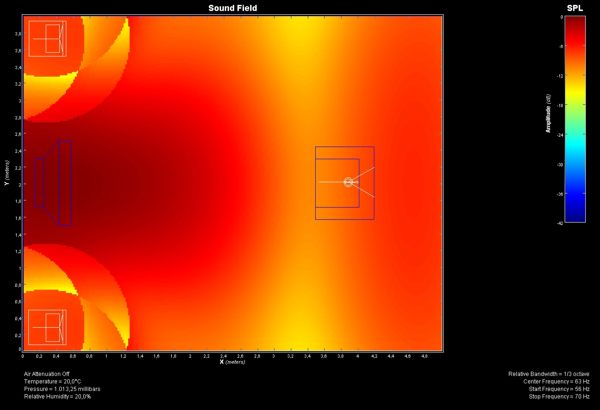

DUAL SUB´S FIELD RESPONSE # 2 of 3 - (10´ separation)
In the Prediction #2 the sub´s are 10´ away from each other.

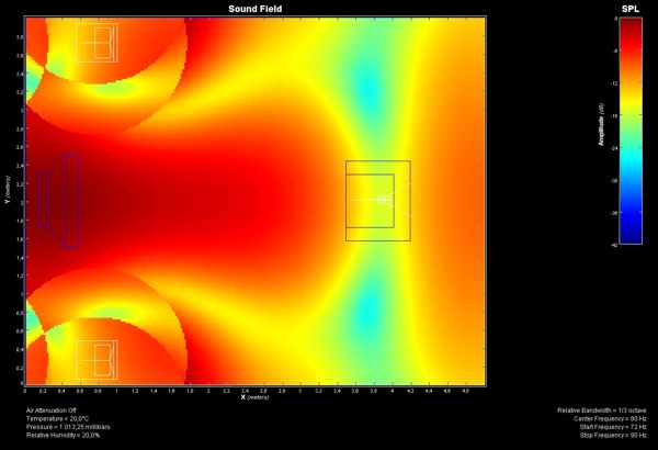

DUAL SUB´S FIELD RESPONSE # 3 of 3 - (20´ separation)
In the Prediction #3 the sub´s are 20´ away from each other.
