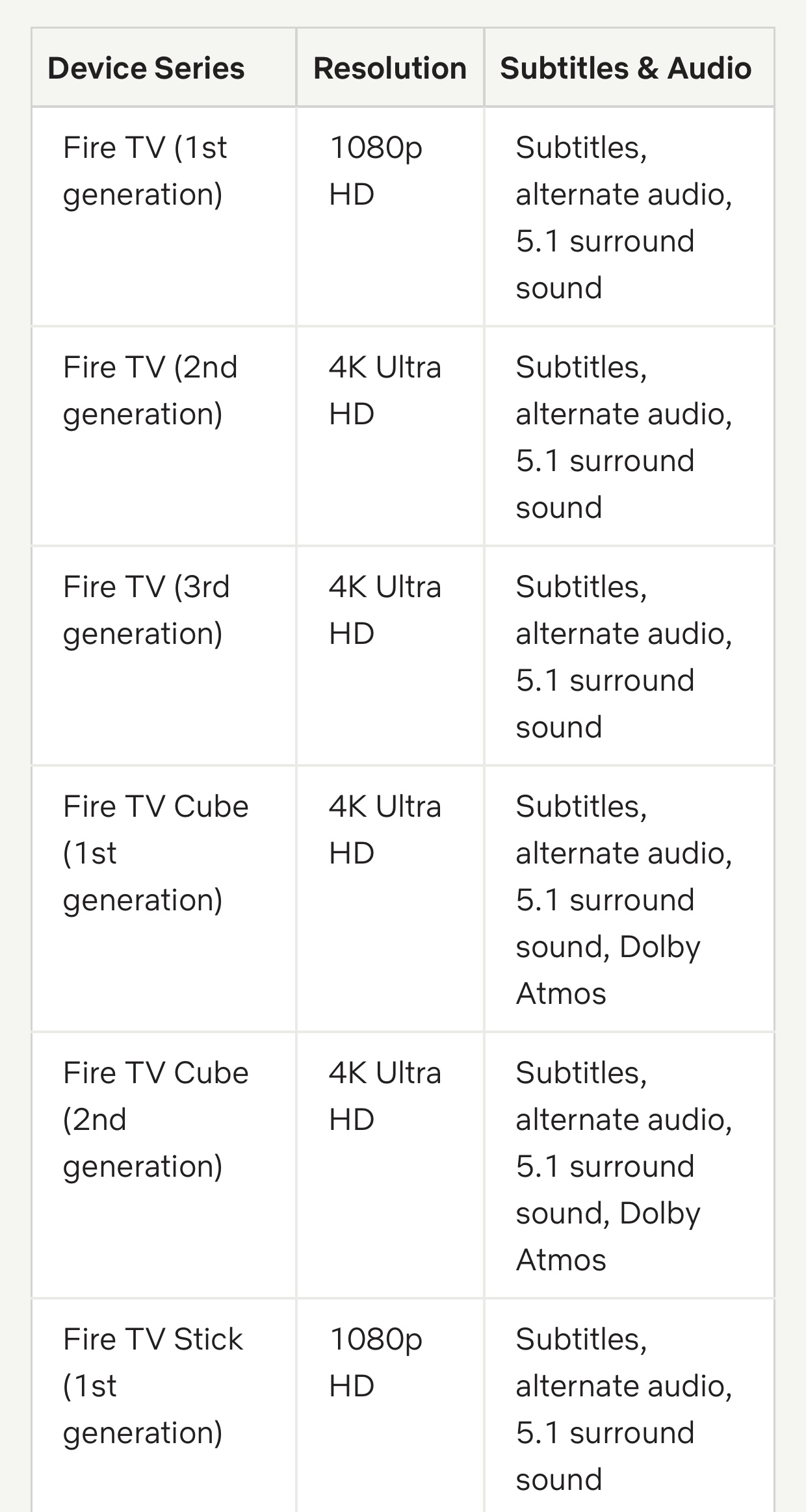

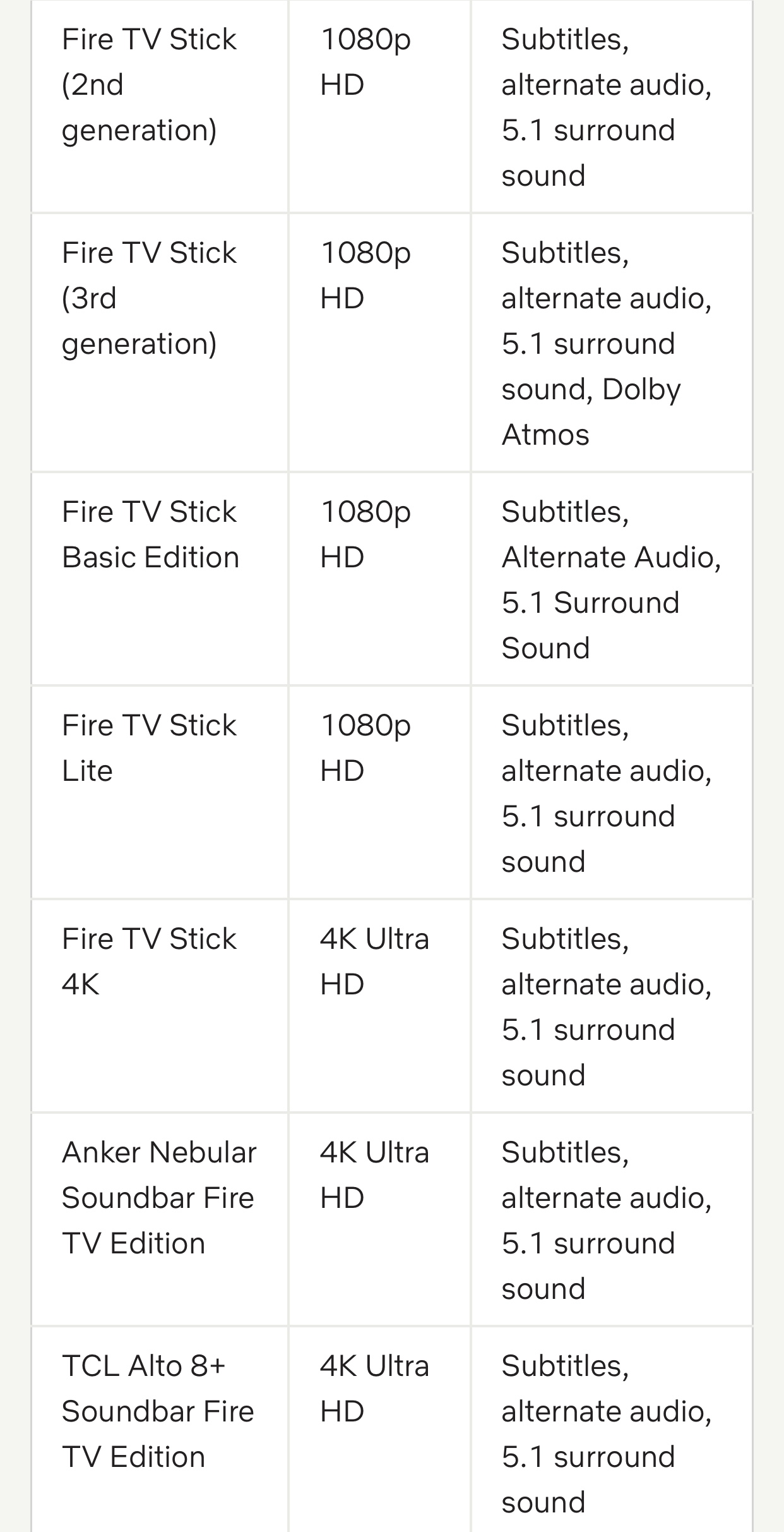

Which models of Roku and Firestick are you using to stream? Roku Ultra will get you atmos passthrough. Different models of Firestick support atmos from Netflix. Here is a list from Netflix but not sure if updates have changed things.
View attachment 45003View attachment 45004
Roku express as description says it’s compatible for atmos, I will try roku ultra
