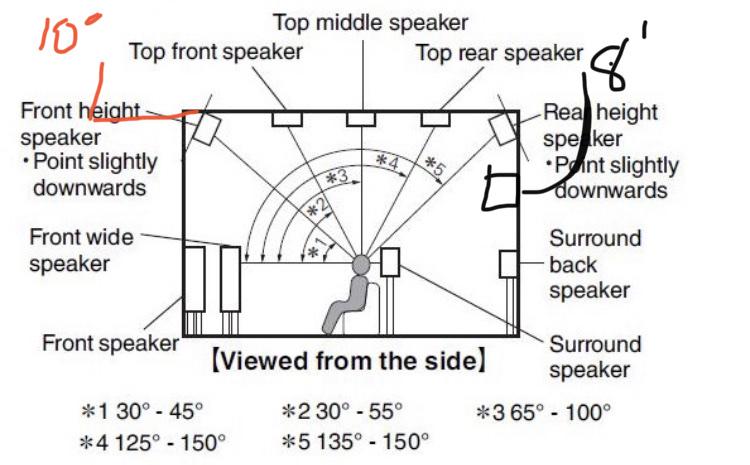

Hey there, I was hoping to get clarification from Gene or some of the other guys. In the article and video, Gene calls straight up 90 degrees, and states he places his atmos speakers 25-35 degrees away from the main listening position.
Dolby's diagram has straight up as 90 degrees, and the smaller the angle the closer it is to flat/ear level. So if we were to put Gene's preferred angle on the dolby spec, it would be shown as 55-65 degrees, which puts it closer to directly above your head, correct?

I have zero idea of what you're trying to communicate. Gene has top heights, angle *2 in that drawing. Dolby spec is 30-55 degrees, I just want to confirm that Gene's would be, on that drawing, 55-65 degrees (as I previously misunderstood and thought he was at 25-35 degrees on that drawing)
William Lemmerhirt
William Lemmerhirt
I actually haven’t watched the video. Just giving you a visual. Ignore the doodles, that was for something else lol.
I know what you are saying. It makes it VERY confusing when some people give the angle based on the top of your head like 25º from directly above your head. I think you are right..the 25-35 Gene uses is 55-65 in the correct way of expressing it as per the Dolby guidelines.
