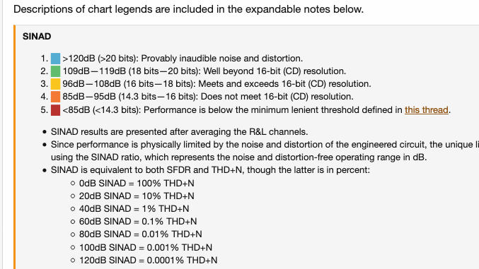

I find this quantification , on ASR, of SINAD & THD+N , ... along wth his notes at the bottom ;-)
"Please don't look at this graph too accurately. Small differences are not material and results vary slightly from test to test. Generally look to see what bucket the DAC falls in (color coded in the chart for easy reference: blue = best; red = worst). "
So anything Green(and upper yellow) & above should be safe. Do we have to define the absolute SOTA? , when the measuring guy says dont look at the numbers too accurately ;-)?

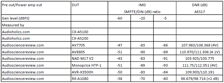

This is the comparison table for IMD (lower better) and DNR (higher better):
So with DNR (Do Not Resuscitate, right @TLS Guy ? :D), ASR sometimes uses 4V, sometimes they don't specify how many Volts?
With IMD, which figures are more "representative " ? -5dB?
Besides the usual "it depends" and "all of the above" answers, which parameters are salient when determining SOTA or "best engineering and quality " in electronics?
Distortion (THD) and Noise (SNR) - and their various nomenclature?
A lot of people also measured Crosstalk and Freq Resp, but these are less important?
