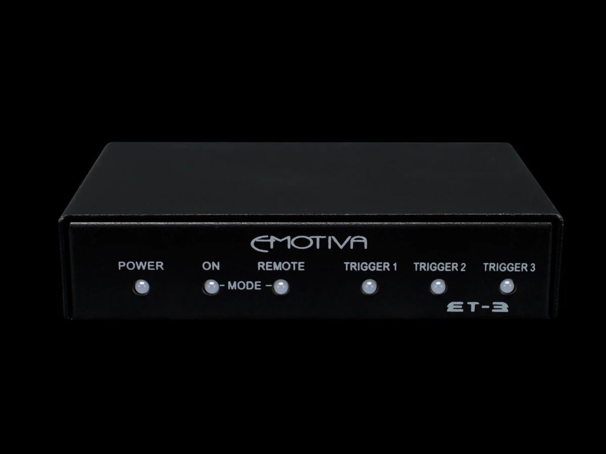

OK, Thanks WaynePflughaupt. So that solves that issue. This unit looks like it has a 12V trigger in so that would receive a trigger signal from an AVR lets say, and power up any number of external devices and also provide power conditioning. Pretty good solution.

Yup, there it is. Exactly what I was wondering about, and it's affordable to most anyone. It's weird how that didn't turn up in any of my searches. Thanks slipperybidness.
