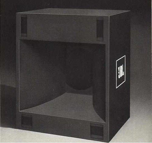

I too was once the happy owner of a Marantz 2325. You probably won't believe me, but I used it to power some large 4560 JBL bass bins / Lamelex Horns with Peavey Spider Drivers, and banks of Piezos on each side (with a Pan Fan on top of the receiver to help cool it) in my part time DJ days. I did some pretty large dances (hundreds of people) and it performed every time without a hitch. It was my home stereo for quite a while until some Thug broke in and stole it while we were at work.
One of my brothers bought the speakers from me and still has those monsters all these years later. He recently unexplicitly lost the hearing in one ear (which is bizarre as he almost never was exposed to loud sounds), and is now trying to sell them.
The Marantz 2325 was the best stereo receiver I ever owned as it was at the zenith of their capability in home stereo receivers. They were the premier OEM at this time. Probably no where near as good as what's out there today, but I have fond memories of it.
