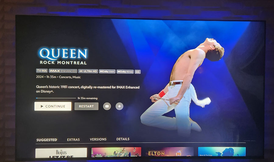

As of May 15th, 2024, Disney+ subscribers with select AV hardware will be able to experience Queen Rock Montreal alongside 18 Marvel movies with IMAX Enhanced sound. This marks the first time that the DTS:X immersive audio format will be available via a major streaming service. At launch, only select Smart TVs can pass the DTS:X Audio to an AV receiver or soundbar. Will this limitation make DTS:X irrelevant in the Dolby Atmos era?
Not so fast. I just tested the Queen Montreal concert streaming on Disney+ using his Marantz AV 10 processor, Sony Bravia 85" X90L and Apple TV Gen3 and was able to pass IMAX Enhanced but only the Dolby Atmos soundtrack. As of right now, Apple has not announced support for DTS:X on Gen3 streaming platforms. The only external streamer rumored to currently support DTS:X streaming is Nvidia Shield. 2023 Model year Sony TVs don't seem to support DTS:X and it's unclear which models on the market from other brands do.

Apple TV 4K, all generations, do not support DTS at all so it is a no go there. The Fire Cube Gen 3 does not support DTS streams at all either but can passthrough DTS from an externally connected device via its HDMI IN port. Nvidia Shield TV Pro supports DTS and DTS HD MA streams as does Roku Ultra 4800X. But, Disney+ is currently blocking IMAX Enhanced audio output to them. My Shield seemed to try to work and then the Disney+ app not only stopped working, it shut the Shield down and I had to reboot. Later, it only passed Dolby Atmos. There are other issues with Disney+ and the Nvidia Shield TV Pro, but that is for another thread.
Anyone with an XBOX Series X/S knows that it supports Dolby Atmos using Dolby MAT 2.0 like the Apple TV 4K or Amazon Fire Cube. But, must download the Dolby Access app from the Microsoft store. They can also output everything as DTS:X after downloading the DTS app from the Microsoft store. But, the Disney+ app for XBOX does not currently support IMAX Enhanced Sound By DTS( lossy DTS:X ) and setting the XBOX audio output to DTS:X means Disney+ will give you a DD 5.1 signal that the XBOX will output as DTS:X. It will not be the actual IMAX Enhanced DTS signal.
All but three of the IMAX Enhanced titles from Disney+ feature DTS:X. “Iron Man,” “Guardians of the Galaxy Vol. 1” and “Lightyear” do not currently have a DTS:X track. Curious what deals were signed with whom and when to botch such a long awaited roll out. But, Disney isn’t doing many things right these days.;)
