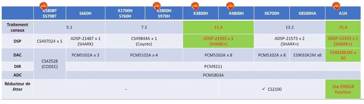

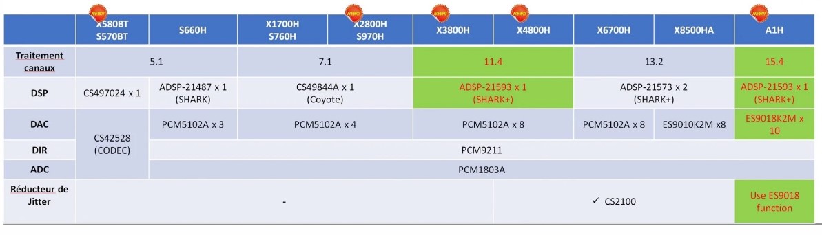

On a more technical note, all the models with the new dual core ADSP-21593 chip will be capable of Dirac ART:
I tried looking up the LX805 but couldn't find the spec that could actually support DL ART.
Is there any news on the LX805?
Sent from my SM-S916U using Tapatalk
ban25
ban25
No, there's unlikely to be any news until Storm Audio's exclusivity regarding DL ART ends later this year.
