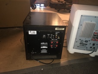

Hello all,
Waiting for my UMM6 calibration mic to arrive today. In the mean time I’m trying to figure out what sub(s) to use. Unfortunately all seven subs are of different power levels, ported & sealed, some don’t have LFE, some have stereo RCA & some only have mono, some but not all have in/out functionality, some have phase and/or delay dials.
Can some one help? I can provide any additional details needed. Thank you!
A list of make/model numbers would be far more useful than those pics. Might also look into Geddes' sub guidelines.

#1
RCA
PRO-SW200P
200watt
Front firing ported sub
No LFE
Stereo low level input
In/out high level
#2
SVS
SB-1000
100-300watt?
Front firing sealed sub
Has most connections except high level out.
#3
JBL
AEH50
200watt?
Bottom firing/front port
No phase or delay adjustments

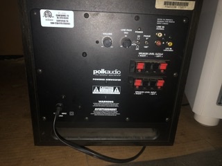

#4
Polkaudio
PSW303B
100watt?
Forward firing/Rear vent port
#5
Onkyo
SKW-570
163watt?
#6
Onkyo
SKW-591
35watt?
Bottom firing/ front port
#7
Onkyo
SKW-791
35watt?
