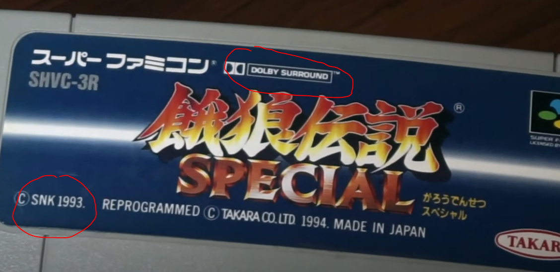

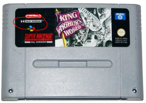

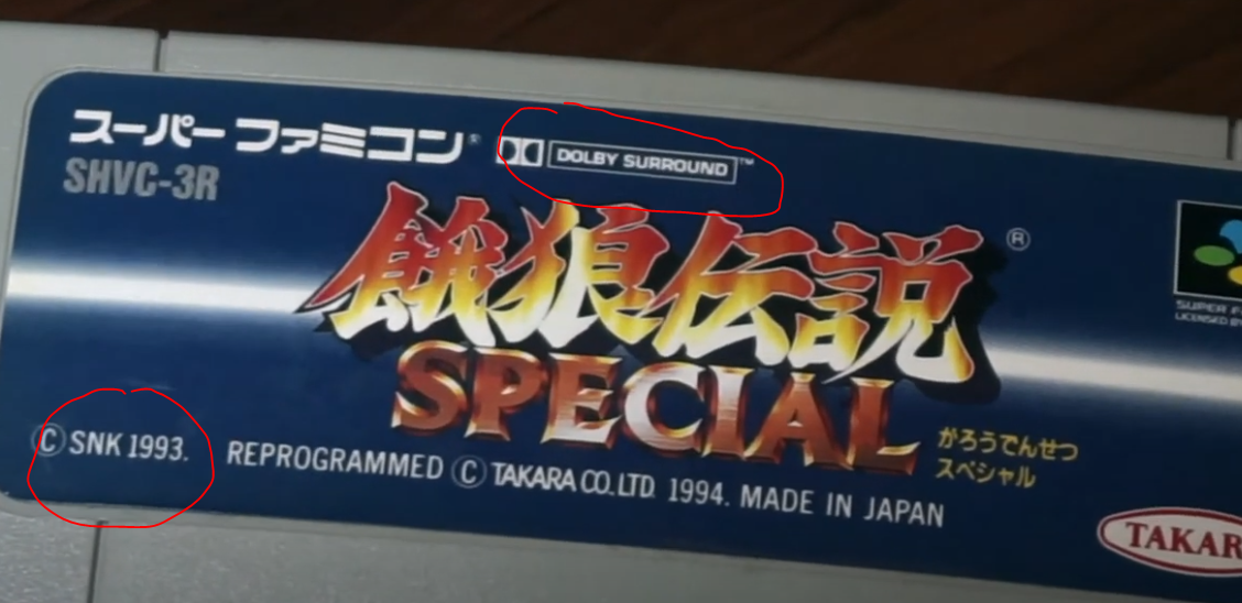

View attachment 59684 View attachment 59685
Maybe someone who knows how the branding generally worked in the 1990s could speak to whether it was common for the branding terms to be used interchangeably?
Is it possible that games and video tapes were stamped with the original logo, even though their soundtracks were actually mixed in Pro Logic 1?

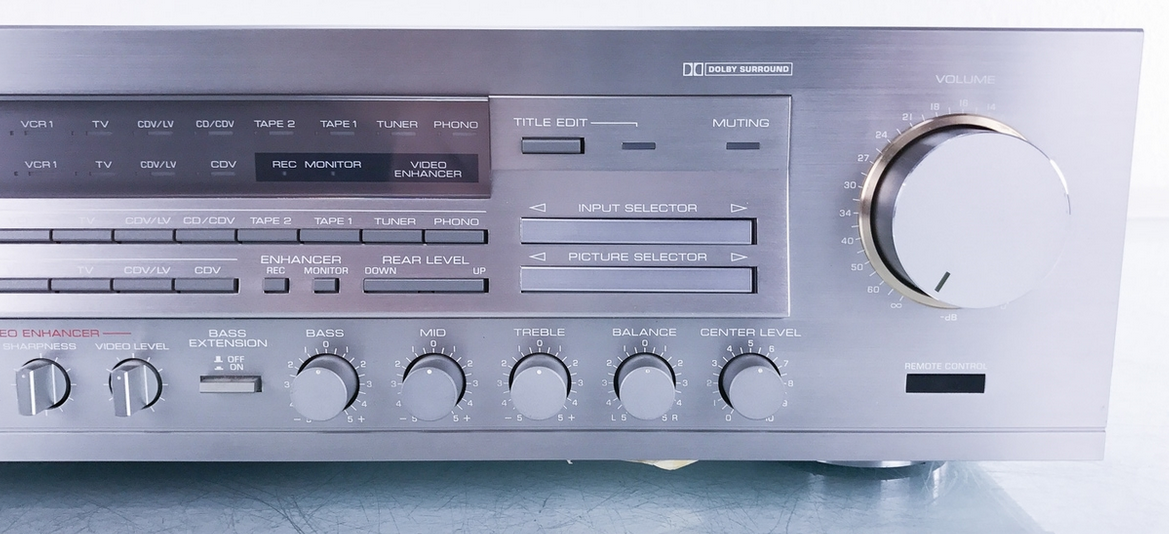

My Yamaha AVX-100 Dolby Surround* (not Pro Logic) integrated amp, c. 1987, had a center channel out with a nice rotary level control (as seen on this silver one below), but I suspect it was really a Yamaha feature, not a Dolby feature?
*confusingly this term can mean different things in the consumer world vs. the commercial cinema world and to add insult to injury Dolby redefined what it means around 2014.
