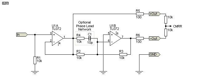

I took a look of the XLS1500's SM, its balanced and unbalanced implementations are based on common practice, as described by Elliot Sound:
This is a common circuit, and can be found in hi-fi equipment, commercial (live sound) gear, and almost anywhere that a balanced output is needed. As discussed above, it's not perfect because one signal is delayed by only U1A (which is immaterial in this arrangement), but the other (inverted) signal has the extra delay of U1B. When combined, they are not (and never can be) perfectly matched at all frequencies. The small time delay (aka propagation delay) of U1B plus its high frequency phase shift means that the two signals are not exact but inverted replicas of each other. There will always be small amplitude and phase errors that mean the summed output is non-zero.
As one would expect the XLS1500/2500 did not use the best OPA, and obviously not fully balanced end to end that are rarely used in low, mid, to even most so called high end gear (except a few, such as certain models of the Emotiva and ATI amps as they are not super expensive, yet claimed to be fully balanced end to end), so you are not going to get SINAD much better than 70 dB, but that's more than meeting their specs. 70 dB SINAD is 0.03% THD+N, that's well below the widely accepted threshold of audibility as far as THD+N goes. I doubt anyone can tell a difference comparing your XLS amps vs the likes of Marantz, Denon, Yamaha's flagship AVRs or integrated amps (on all else being equal, and non clipping basis) except under some specific use conditions, naturally.
Balanced I/O (sound-au.com)
