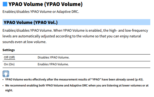

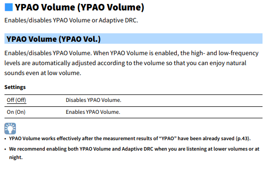

In the manual I see this:
Isn't that the same as Audyssey Dynamic EQ?
Oh, you have a good point there.
Yeah, that sounds just like Dynamic EQ, which boosts mainly the low frequency and little of the high frequency.
So when you apply YPAO Volume, it should boost the bass (probably 30Hz-90Hz) and also the treble (probably above 15kHz).
