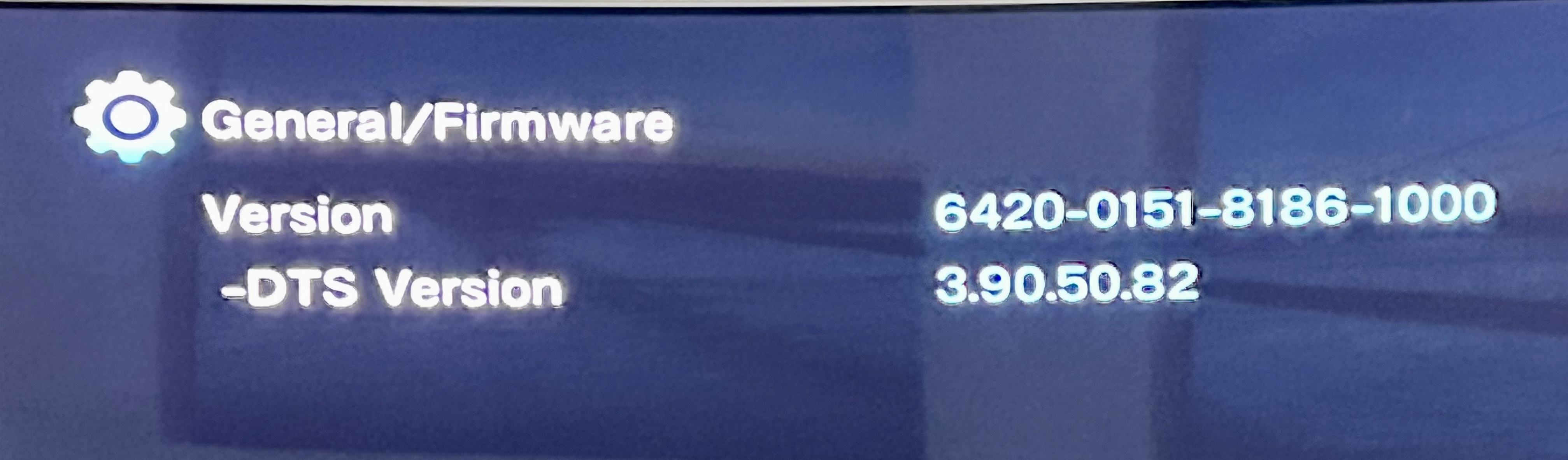

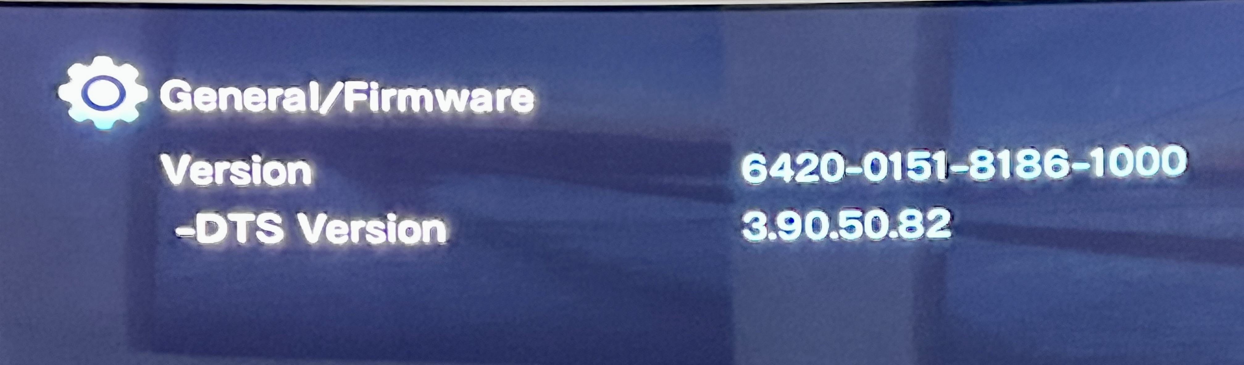

Does anyone know what firmware# 6420-0151-8186-1000 adds to the Denon receivers? I got the update this morning. Do you guys think it has anything to do with Disney+ adding IMAX Enhanced content to their Marvel movies tomorrow?
