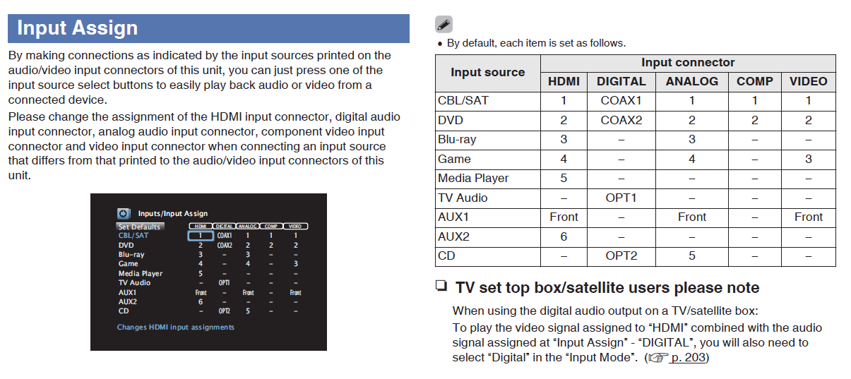

I don't think he's talking about the TV but the Denon, as shown in the Owner's manual page 119:
If your CDP, DVDP, or BDP is connected via coax, opt, or analog, it shouldn't be affected by your TV. If it is a DVD or BDP player connected via HDMI, then you need to have the HDMI related settings done correctly. Assuming you have done everything right on the Denon side, you should read the manual of the TV and make sure you have everything set right also. I don't have time to read the Samsung's manual until next week, but hopefully you can figure that out yourself, or someone familiar with Samsung (that particular model) will chime in and help you out.

I have 3 blu ray players, one android box and one Roku box connected to the Denon through HDMI. I have tried every configuration on both the Denon and Samsung that I can think of. My former tv (Sharp 70") would run a picture of a cd tracks when I wanted it to. When I would turn off the Sharp, there would be a brief audio blank and then sound would be coming thru the Denon as normal. I have no trouble accessing any of my inputs to play. I simply have not been able to turn the tv off and still play a cd. When I turn the tv off the sound blanks out on the Denon after about 30 seconds. It will only come back on again if I either turn the tv back on, or pull the HDMI cord from the receiver or tv. I will have to make a trip to Best Buy and find out if they have any suggestions. I bought the tv there and they also sell Denon.

I took the easy way out. I have tried every different setting that I could think of and nothing worked. I ended up getting one of my older Panasonic Blu ray players that had analog outputs on it and plugged only the stereo jacks into the Denon's cd inputs in the back. Works as it should that way, but I really shouldn't have to do it this way.
