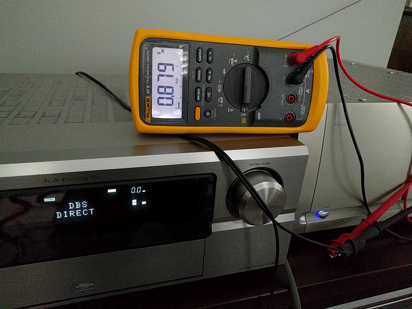

I played a 60s long 1,000 hz sine wave tone on either my universal player, or one of my external dac. Most downloadable tones on the internet are short ones, like 30 seconds. That will be fine too but I prefer longer ones as it makes the job easier and quicker. Then I measure the output of the source player (universal player, cd/dvd player, dac etc.) and then the output of the preout of the AVR. I only measure the right channel. Make sure you set the meter to measure AC voltage. If you set it to DC, you will get a very low voltage, the lower the better becaus e you would be measuring the offset voltage.
I'll try that. I was using DC and just playing music. I'll try a sine wave and see if that gets better results.
Problem with using music is that it fluctuates too much. I will still give you an idea but a very rough idea..

Yes, they should be level matched like that. I have run the calibration and checked the levels with the decibel meters afterwards.
I got very consistent results using a sine wave, but I think my multi-meter isn't the most accurate. It's an old Radio Shack that has pins and not clamps. I placed the red pin on the end of an RCA cable and got 1-1.2v with the lowest AC setting on my meter (200). This was at multiple tones and the results were always within that range.
I think in order for me to say these are accurate results I need a better meter, and probably a better way to clamp onto a cable without a connector on the end.
I stripped one end of a red/white RCA interconnect, one of those cheap one that came with a 39.99 DVD player. Then I use the crocodile clips for a solid connection.

You said the spl was low at mv=0, but Audyssey must have calibrated the system to give 85db average at mv 0 from your main sitting position.
If you do get 85db when playing a Blue ray movie that is mastered to thx standard, then it is not "surprisingly low", if not then something is wrong for sure.
I suggested CD player because they typically have higher output.
I am still not clear if you have actually done an apple to apple comparison.
For an apple to apple comparisons you have to use the same source program and player, and equalize their gains. You can't just set the Denon volume to 0 and compare it to the Marantz integrated that is set to some unknown level and driven by a different source.

Second step, if you choose to set the Denon mv to 0, then you have to determine what is the equivalent volume position of the Marantz mv.
The Denon's mv goes from about -79 to +18, how about the Marantz, is it analog, or also digital?
The Marantz goes from -100 to 0 and reaches peaks of a 100db around -20/18db (same song, same source(Bluesound), but with analog outputs so not really comparable probably)

Now that you have found the main reason for the discrepancy in spl between the two configurations, you can increase or decrease the source level for each input to balance things off.
As I mentioned before, the position of the master volume when the preamp reaches 2V rms depends on the source output (input to the Denon) level, not just the maximum gain of the preamp. So if you "boost" the source level, your Denon's preamp output will reach 2Vrms sooner because you are effectively putting a +offset on the master volume.
As for risk, based on the measurements I have taken for you, I am confident that if you don't go pass "0", your Denon will stay below 2Vrms, the peaks could be much higher though.
To be on the safe side, it is better to use your BR player's output level as reference because Audyssey should have calibrated your AVR to produce 85 dB average and 105 dB peak from you main listening position with master volume at "0". If you boost any source input too much, you will increase the risk of reaching of 2Vrms at mv 0, though unlikely. Then again, I wouldn't worry about that at all because that will most likely only happen during the highest peaks of the program material; and the Denon preout reached 4.5V when it clipped, according to Gene's measurements. In fact, your PM11S3 would clip sooner.
Just one last step, please check and let me know the level adjustments of each channels.

Oh no, so sorry, I messed up taking the measurements earlier today, I run the subwoofers hotter on the Bluray because we use it only for film and I might have forgotten to turn them down. Or I might have messed up something else, too many options :) (same with the chromecast). The sound levels are all identical if the subs are set to the same gain. That makes sense actually because they're all connected digitally and the levels then depend on the DAC in the Denon that they're all running through.
I'll have to try an analog connection and see what that does, but I'll have to get some new interconnects before I check that.
I think I'll gently try to boost the source level in small increments in the mean time and just listen to hear how that sounds. I might also try to rerun Audyssey to see if that somehow helps.
Found a cable and tested with our Squeezebox (which has an output voltage of 1,8v) and got more or less the same results there too. Unsure what that means because I'm unsure if the X3300 digitizes the analog inputs to apply room correction and so on.
Anyway, looks like this is just the way it is with this combination of amps and that if I want to get it to play louder I'll have to try to run it over 0db master volume. I might try gently raising the volume over a number of days to see if that works and back straight down if I hear any signs of strain or distortion.
