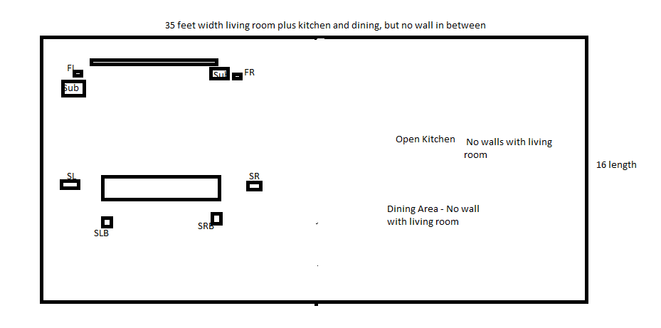

My config in the living room follows.
1. Denon AVR x-4400h
2. Front Speaker - KEF R500
3. Center - KEF R200c
4. Surround sides and backs - JBL 530
5. Subs - Monolith 15" Ultra and VTF-3 MK5 HP
6. Room Size: 16 * 35 ( But it's great room type with no walls between the living room and kitchen. Living room left side 16 * 16.) Please check image below
Based on the info provided, if you listen loud, say with volume at 0, you could be getting close to (not quite, but close) your AVR's output limit. If you listen at -20 to -10, the AVR can do the job easily. Either way, I highly recommend you put at least one AC infinity fan on top of the chassis and powered it from an external USB outlet. You can also try the medium speed (quieter) first to see if that is enough to keep it cool. I kept mine below 35-37 deg C at the warmest spot on the top cover.
