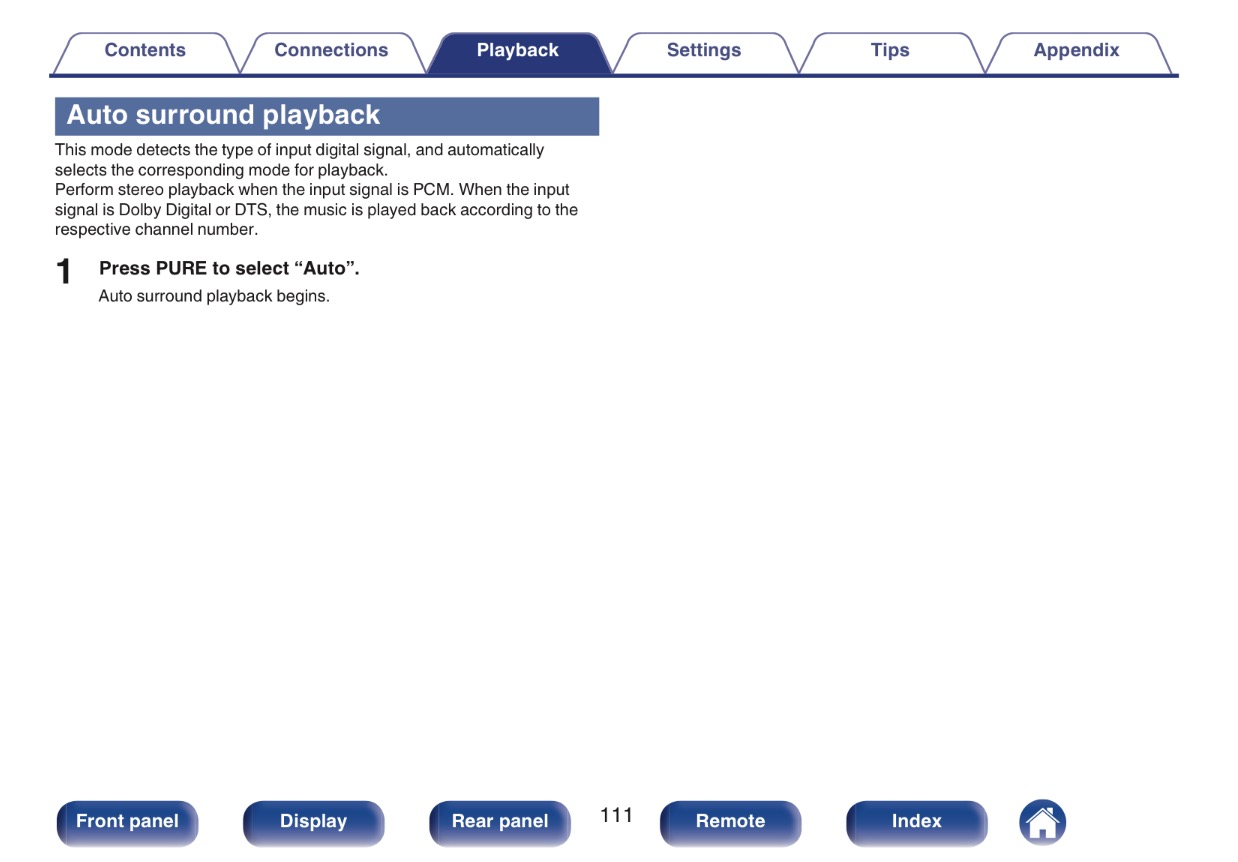

When in AUTO mode, any surround sound source plays in the correct format and is displayed on the front of the receiver (ex. DD+). However, any stereo source gets upmixed to surround and I see DD Surr displayed on the receiver. Its definitely getting upmixed because audio is coming out of the center channel (I have a 3.1 system). If I use one of the mode buttons (MOVIE, MUSIC,GAME) to force a stereo source into stereo mode it will play fine. However, when I go to play a surround sound source, it is stuck in stereo unless I manually switch it to it's native format or back to AUTO. It boggles my mind why I'd have to manual select anything and I can't just play all sources in their native format without upmixing.
Trebdp83
The manual does a poor job of indicating how it all works. It does state that, in Auto mode, PCM and analog signals would be played in Stereo. But, the issue with the Denon and other makes is that when a DD signal is detected, Surround processing kicks in regardless of the channels in the DD track. TVs set to output Dolby Digital will have an issue with Auto mode because everything coming out of it is some flavor of DD and will trigger the Surround up mixer. If it is a two channel track, one is forced to select Stereo mode. Unfortunately, switching the output of the TV audio to PCM results in everything being down converted and coming out in two channel PCM and multichannel signals are lost. There is just no getting around it unless one chooses Direct mode, BUT, this will rob you of the use of your sub with two channel tracks as bass management is disabled and you will only receive the two channel information in the two front speakers.
