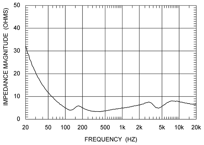

I am sure if you have read some reviews with measurements. Here is one:
Test Report: GoldenEar Technology Triton Three Speakers Page 3 | Sound & Vision (soundandvision.com)
"Minimum impedance is 3.4 ohms at 128 Hz with a phase angle of -31°; and the impedance runs below 5 ohms between 220 and 930 Hz. Impedance rises rapidly below 100 Hz as the signal is handed off to the internal amplifier. Still, using at least a decent midpriced receiver or amplifier rated into 4 ohms would be a good idea. Sensitivity (average of quasi-anechoic measurement from 300 Hz to 10 kHz at 1 meter at 0° with a 2.83 volts RMS signal) is 85.9 dB."

So it is about the combination of relatively low impedance, not so benign phase angle characteristics, low ( relatively speaking) sensitivity, and most importantly the SPL you desired that appeared to be just a few dB below reference level.
A 300 W power amp such as the Anthem MCA225, Monolith 200W X3, or the Hypex NC502MP based Class D amp such as the NC502 and the Purifi 1ET400A should be good.

By the way, Soundstagenetwork.com also reviewed a Trinton but its the newer version the 3+, the impedance curve also shows its more like a 5 Ohm nominal speaker:
SoundStageNetwork.com | SoundStage.com - NRC Measurements: GoldenEar Technology Triton Three+ Loudspeakers

I am actually quite surprise by S&V's comments that mentioned a 4 Ohm rated rated amp would be a good idea, but then it does seem consistent with Triton's recommended 20 - 400 Watt/channel. So I am very interested in that 4.5" mid/bass driver, that seems to be very capable of sucking up lots of juice.:D
May be S&V was just being too cautious, and you may be right that the AVR-X3700H doesn't need help from an external amp. On the other hand, the OP did seem to have to set the volume to -10. I have never listened to music or movie at volume -10, -15 is just about the maximum I can tolerate. For 4 Ohm speakers, -10 would be a heavy enough load for the AVR-X3700H to clip during peaks.
