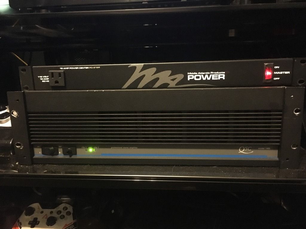

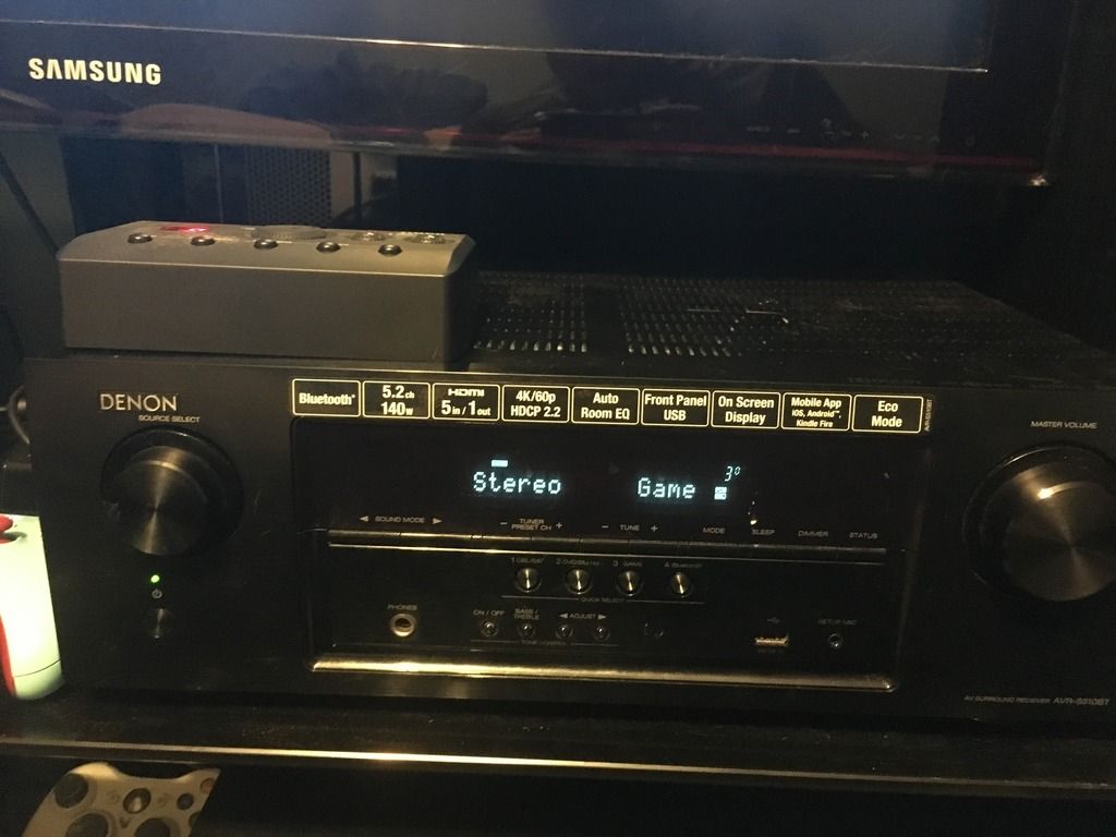

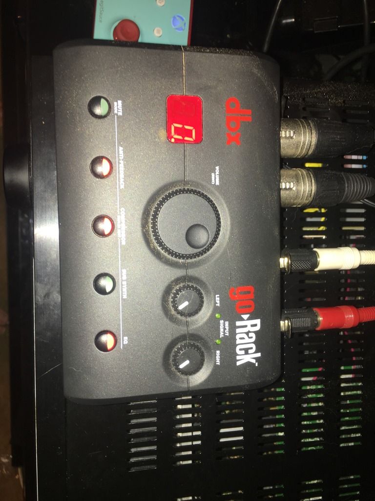

Alright I have taken pictures and a video of what is going on, my receiver is a denon avr s510bt, klipsch reference premiere series bookshelfs and sub. Both of which are ran straight to my denon receiver. I'm not sure what I have commercial wise I know it's jbl professional series 15's and horns and a Qsc amp, hdmi splitter with Dbx eq. My Dbx controls the commercial and the denon controls bookshelf and sub.

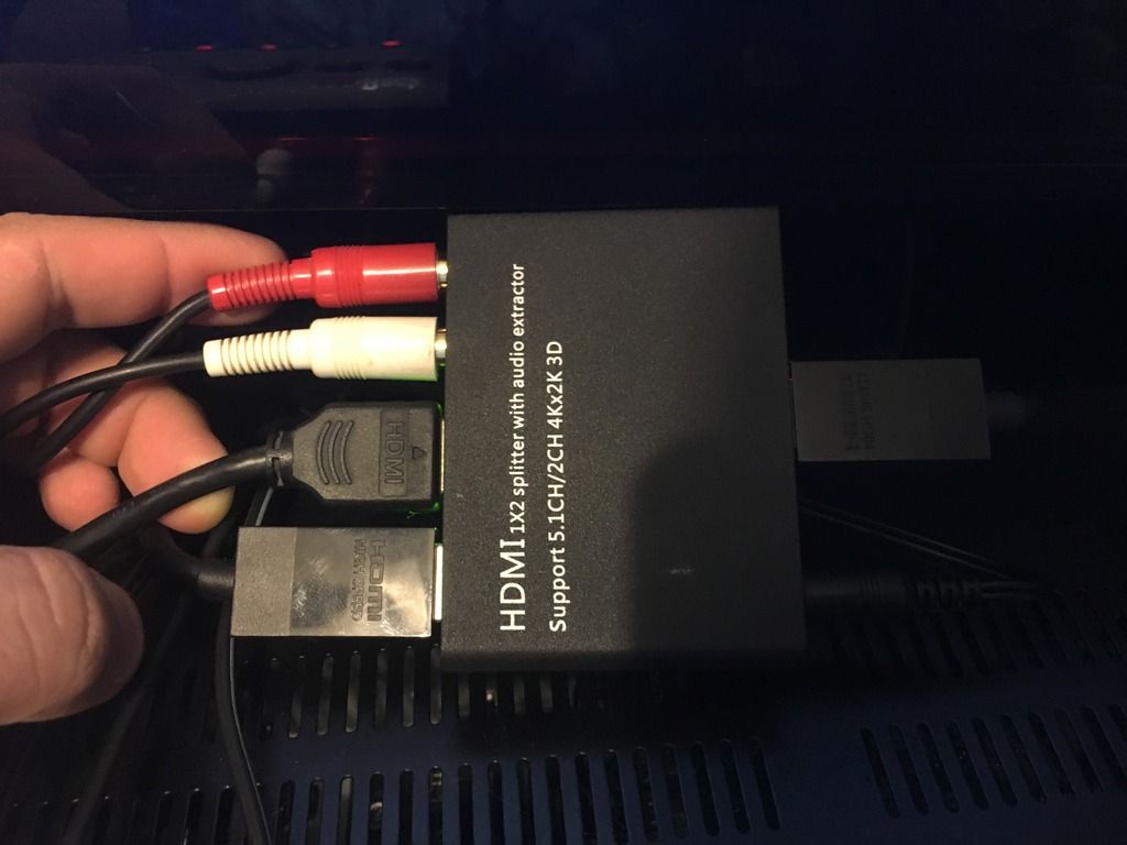

So here's how everything is hooked up coming from my Xbox one the hdmi is ran into the hdmi splitter from there it's splits the signal one to my receiver (hdmi) one to my tv (hdmi) and one to my Dbx via speaker inputs, from my Dbx I have ran xlr cables to my qsc amp which has my jbls hooked up via speaker cable. I hope this helps I'm gonna include pictures shortly.

Pictures aren't all that helpful as would be specific models of gear (like what dbx unit) but I think your problem is that you're not using the avr to control all the audio (particularly the delays involved), the hdmi splitter isn't the way to add speakers and amps (but your avr lacks pre-outs to do it properly). You essentially have two different audio systems slightly out of sync it seems....

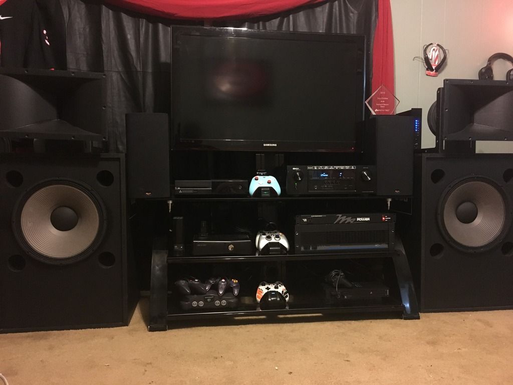

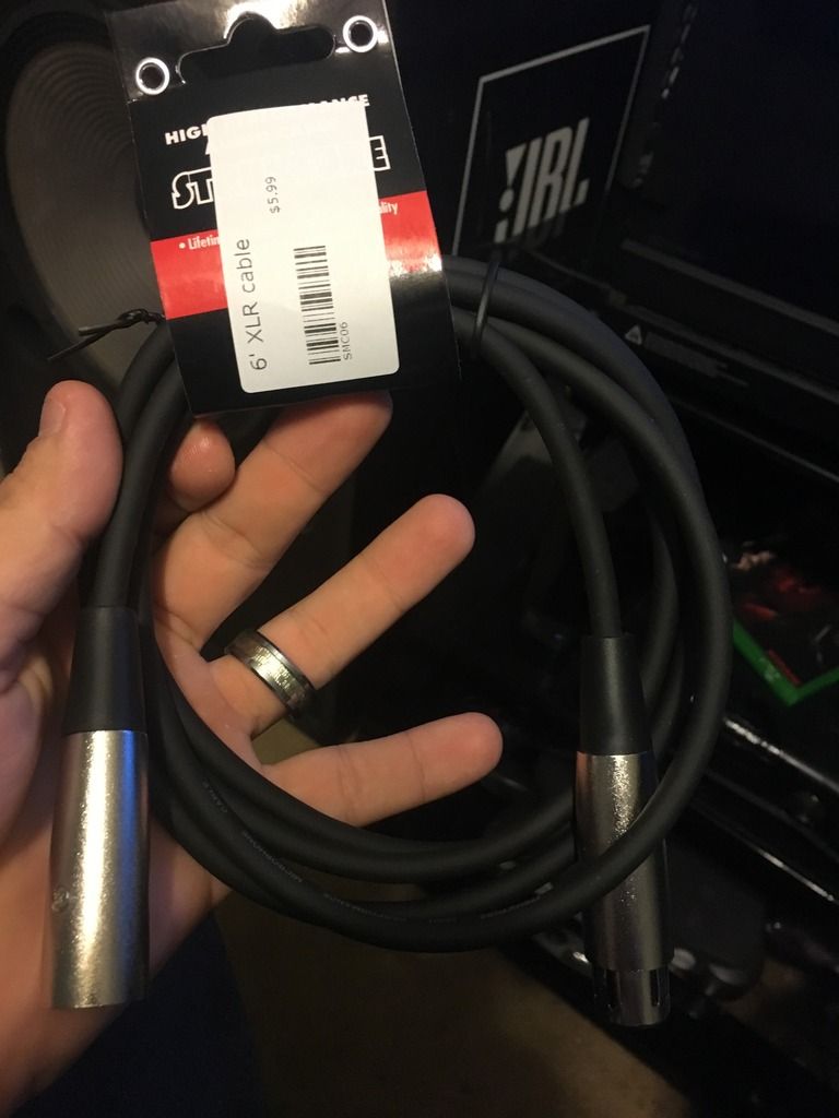

right I cant hook my amp to my receiver as it uses xlr cables/ pre out, also it is two different systems as I have to turn up volume on both receiver and dbx. is there a receiver that I could look into or a work around this? to be honest the theater equipment is unbelievable and could run you out of the room I'm just going for over kill and I paid out the butt for the sub and bookselfs.

Cool amp and speaker score, tho!
thanks buddy, it really is the loudest thing i've ever heard home audio wise and I have way more I just cant fit them in my man cave, I have two of the surrounds that are on the walls of the theater that I'm hanging with another amp, but my bass cabinets just wont fit.

Yeah, those look pretty awesome. Not all beat up either. I'm assuming op is single or WAF just isn't an issue...
I'm not sure what WAF means but I'm married with 3 kids lol this is my man cave!
Wife Acceptance Factor. My wife lets me get away with a lot in our living room, but I keep things clean, neat and tidy. What I don't have is a mancave. That's pretty awesome. I'd love that.
