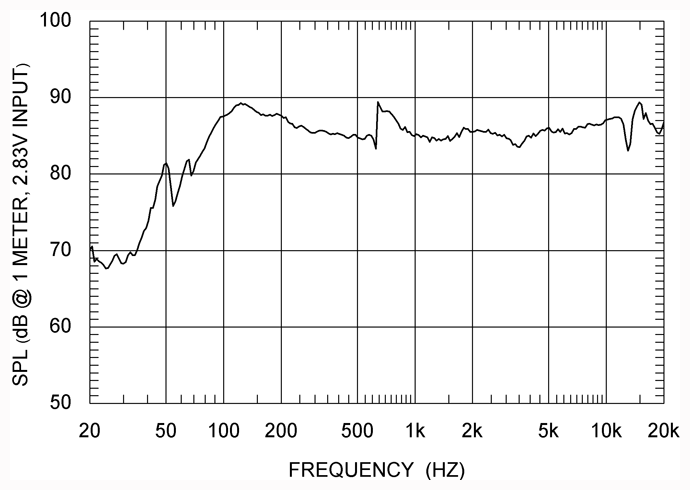

Awesome mid bass from these little suckers though. I can crossover at 60 at full volume and they don't flinch
If it were me I'd cross much higher for better integration. Not taking room gain into account, the roll off of your speakers starts just below 100hz. I'd assume you are missing information at 60hz.
Also note the two humps, those would indicate a rise in mid bass that you are hearing.
B
Bunion
It could be the room. With most music If I crossover higher the subwoofers seem to get too much high frequency information.
I do crossover higher on recordings that sound thin.
I'm constantly experimenting to get the best bass for each specific recording. I've got 9 settings and they're easily changed on the remote control.
